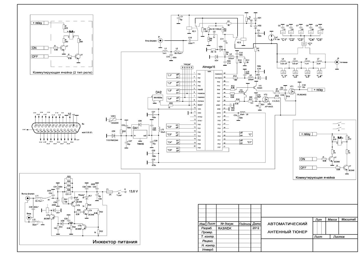

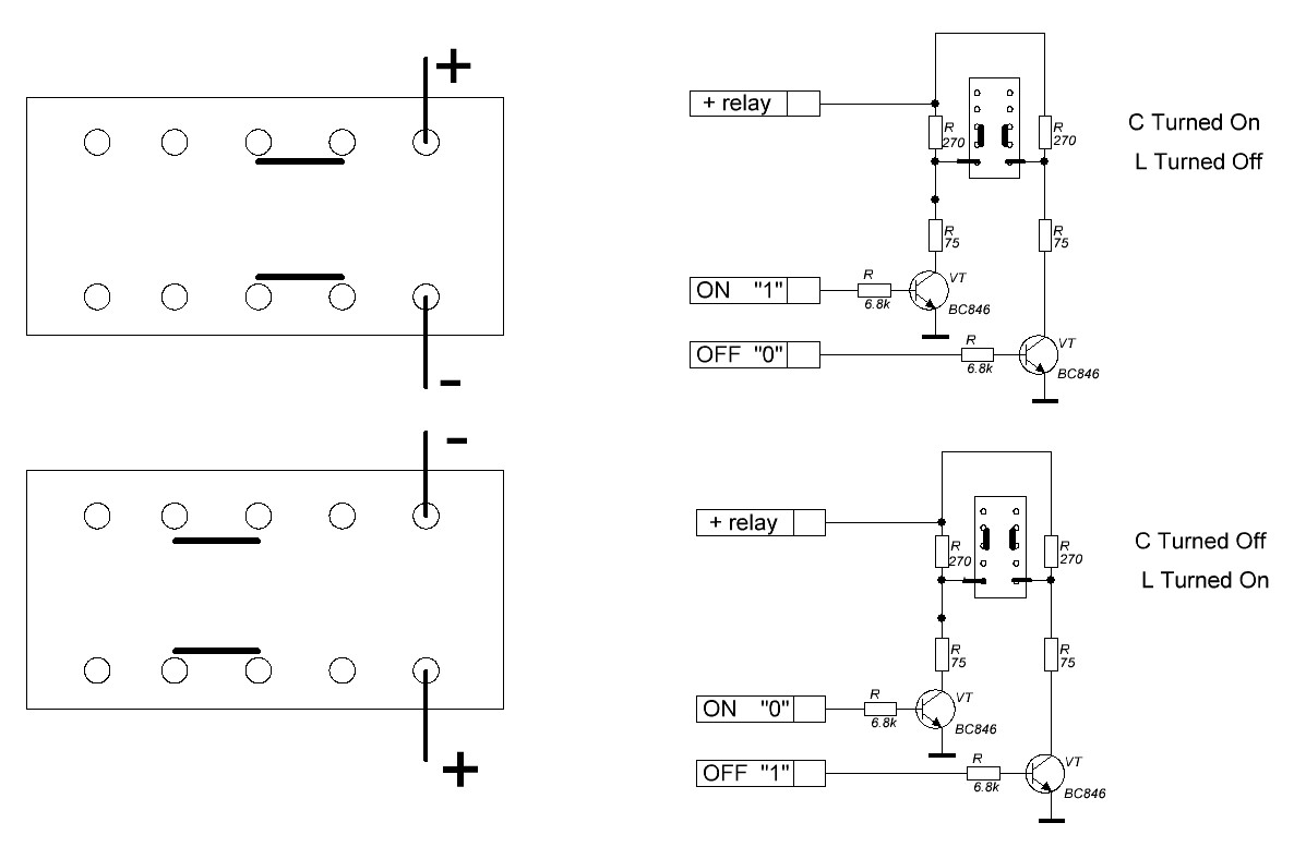

 The actual tuning operation is controlled by detectors (VD1,VD2 and VD3) at the measuring bridge to the matching network. These detectors provide information of the condition SWR to Microcontroller (Atmega 16), which adjusts the L-matching-network constants to achieve the required match. To conserve primary power (important for portable operations) , latching relays are used throughout the tuner for L-matching-network.
 DC injector is necessary for inject DC onto the coax between tranceiver and automatic tuner.
 Only this AT saves low SWR for your TX in all automatic tuning cycles!
 The Microcontroller sets up successive L/C combinations in accordance with a matching algorithm, without measure frequency of the RF signal applied to the input bridge. Finding lowest SWR. Microcontroller not have any information from CAT system and is absolute independent. This AT has five (8 in new AT)"antenna-memory" bank and matching time - about 10-15 sec. AT tunes in CW mode .

Modification circuit of Injector for use with ALC and PTT remoute :

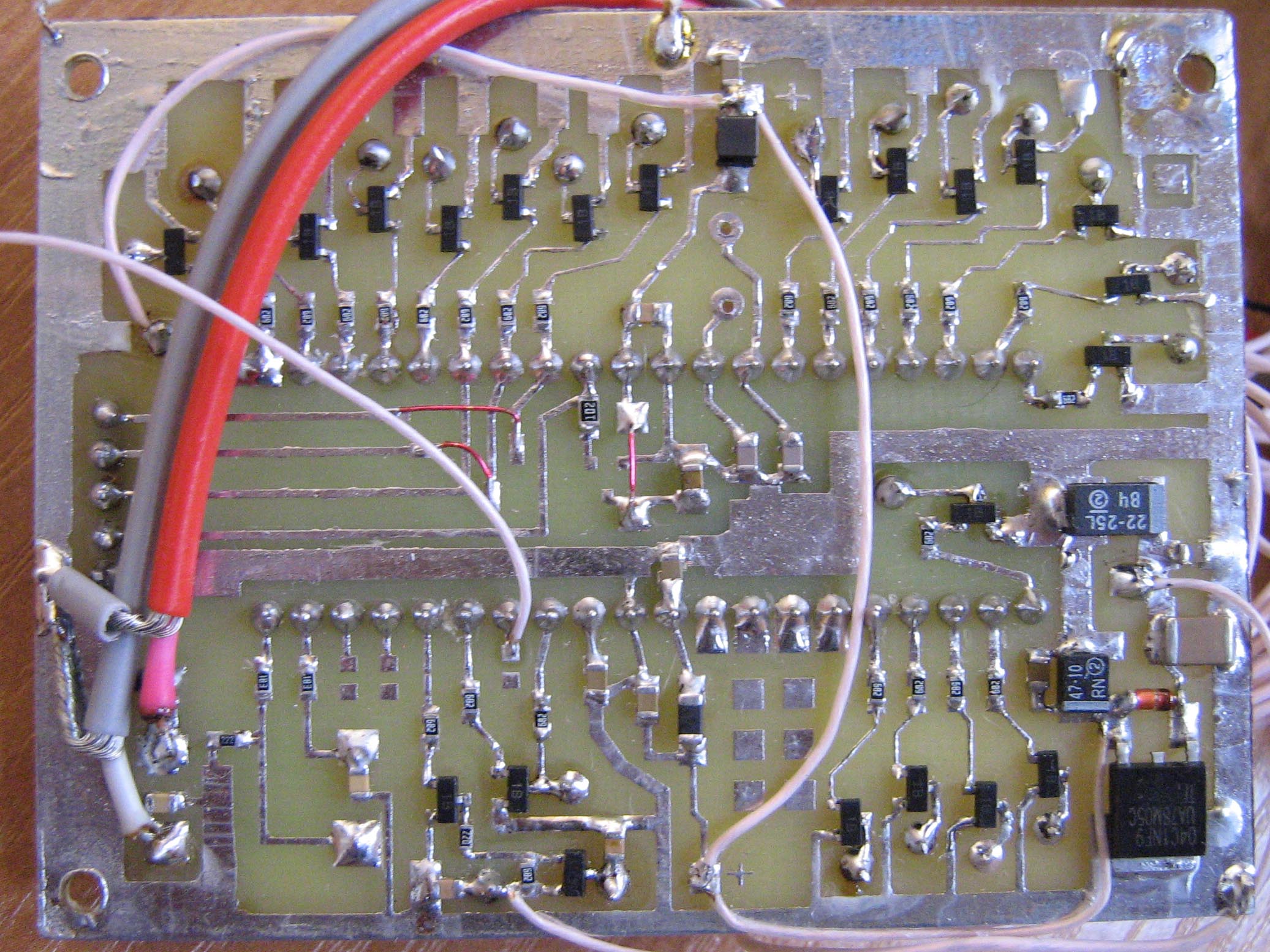

Top of Tuner`s PCB
Bottom of Tuner`s PCB
MCU Atmega 16
Bottom of PCB
Top of PCB MCU Atmega 16

1. How can i check circuit of tuner ? Here many wires, relay ... That easy ! Here you are - HEX file for test circuit
After start - all capasitors and inductor will be turned on .

 Anyway, you also must add 4 keys by BC546 for pin # 7,6,5,4 of port Atmega16.
 Will be good if you use ferrite beads or tubes, which employ for the dissipation of high frequency currents in wire from keys.
New elements has been added from above on Top of Tuner`s PCB
Keys has been added from above on Bottom of PCB
