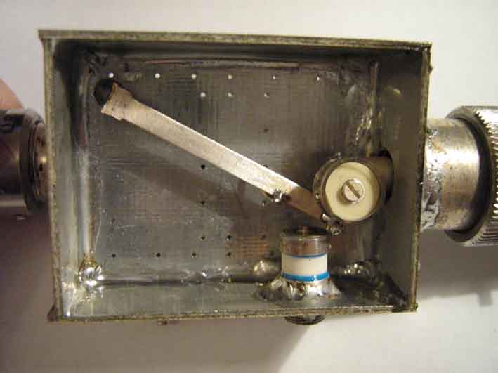

The Cavity LNA has been designed for small signal applications EME in high QRM area
MGF1302 MGF1303 3P373A 3P325
( i use this LNA in this moment )

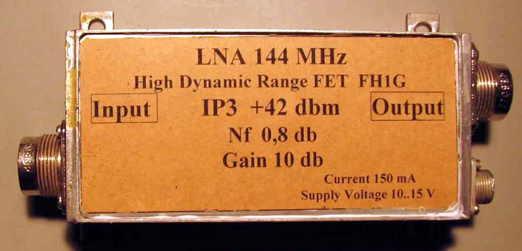

LNA 144 MHz , IP3 +42 dbm , Nf 0,8 db
Made with FH1G, built-in attenuator 5 db

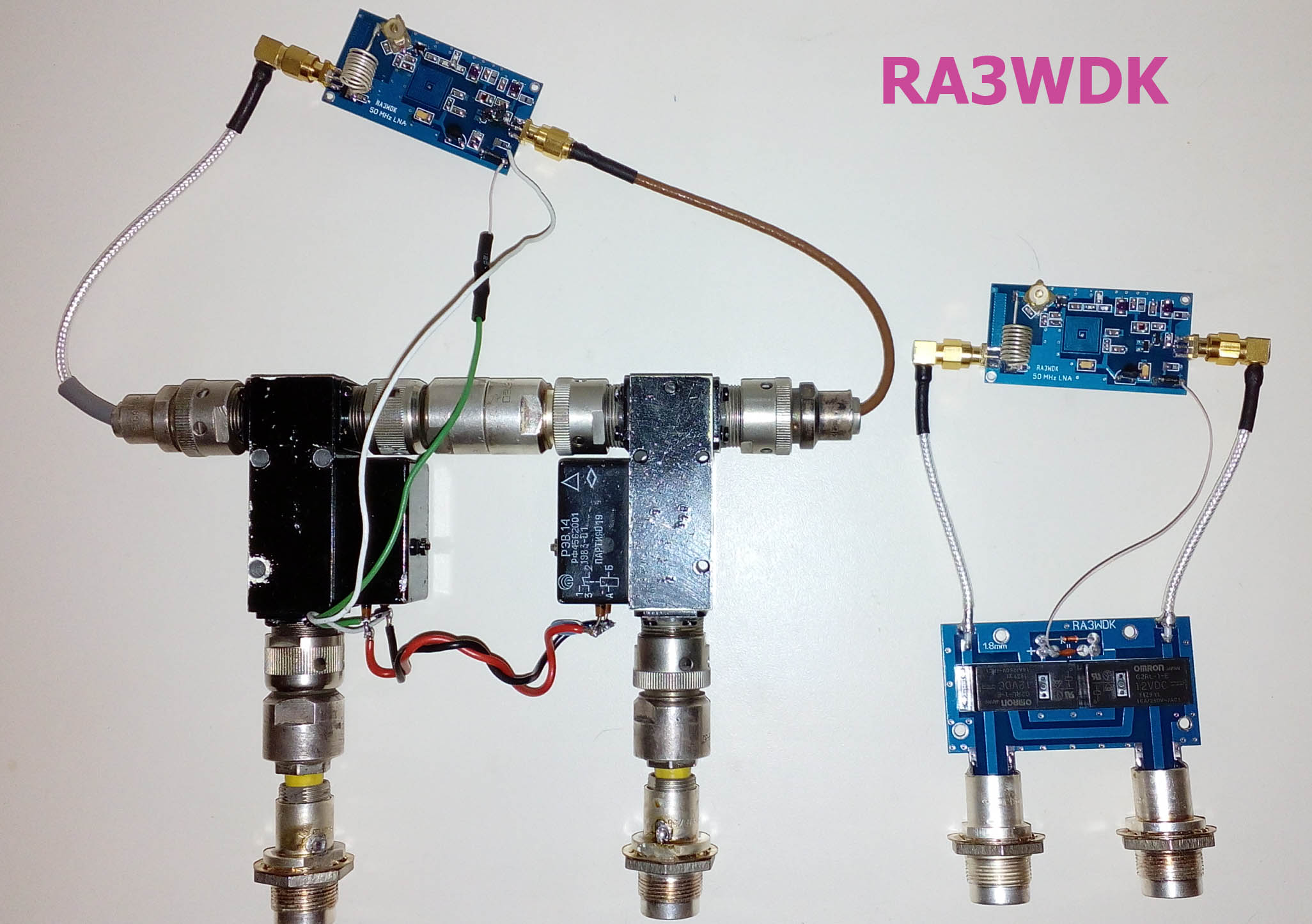

LNA of 144 and 432 MHz band (input of LNA designed for coaxial relay REV-16)

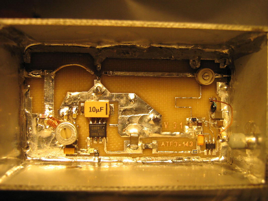

This LNA 144/432/1296 MHz has been designed for TROPO and EME applications
use ATF35143 ATF10136 MGF4919G and russian 3P325 (in my old LNA)

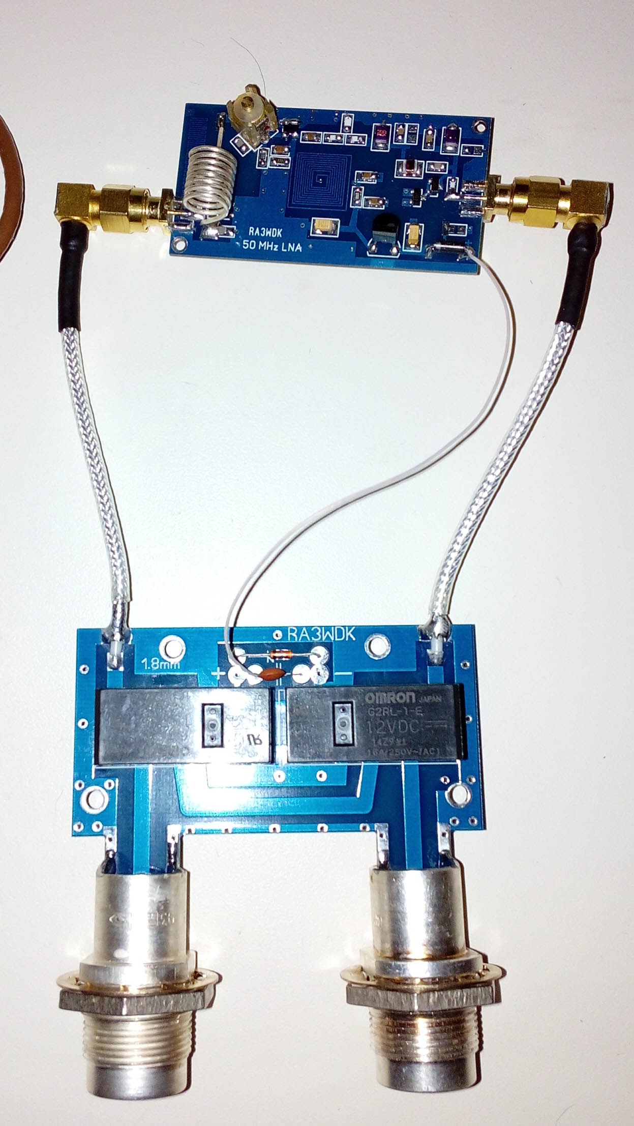

LNA output protection
.... less 1 dB loss !
.... 2W peak triggering !

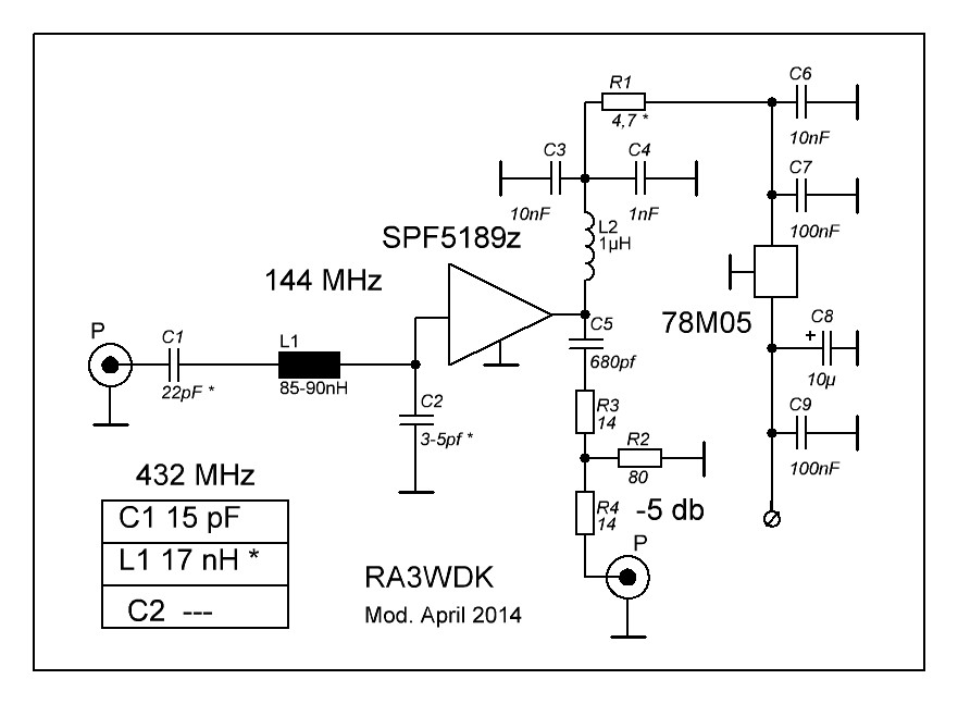

NEW LNA SPF5189z with filter
Repair and modification LNA 144 MHz with SPF5189z
New input circuits (for static protection)
144 MHz
432 MHz

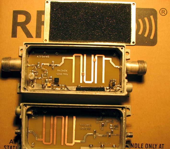

High IP3 LNA for 1296 MHz with BPF
Specifications:
Uds =3,5V Current =60mA
about +30 dBm output 3rd OIP
0.6 dB noise figure
+12 dB gain with BPF 1296 MHz and attenuator 2 db
ATF54143
New design of LNA for 1296 MHz , ATF54143, 50 mA Nf ~0,55db

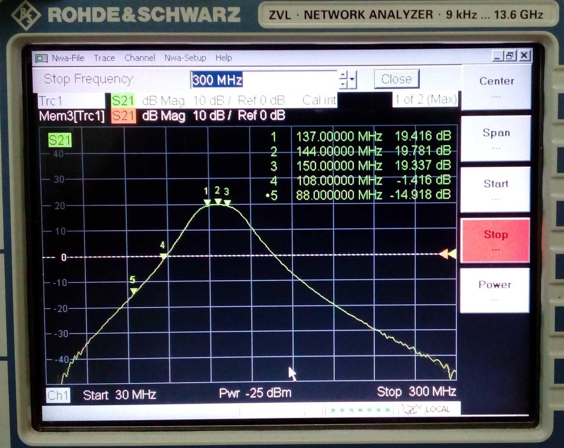

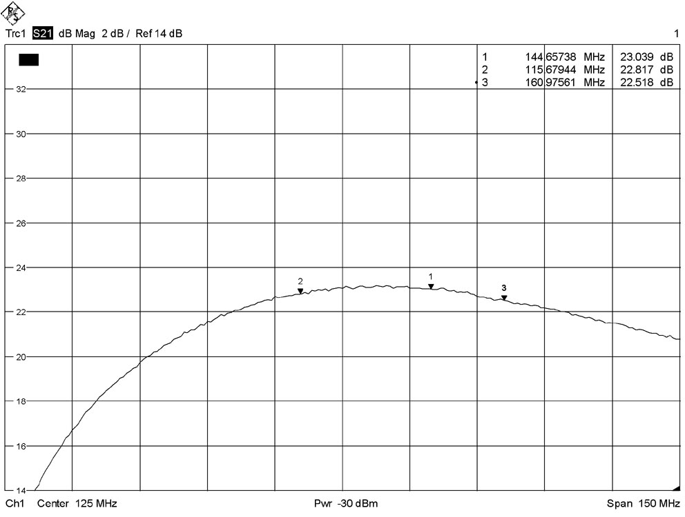

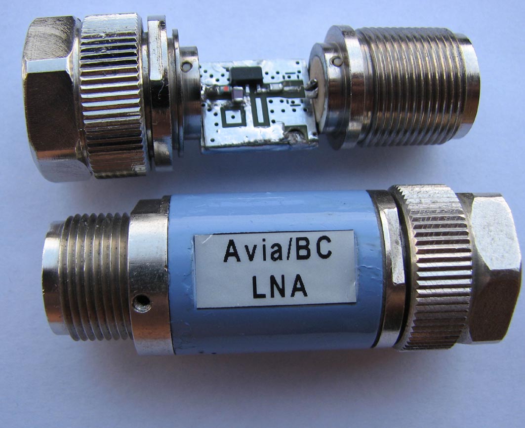

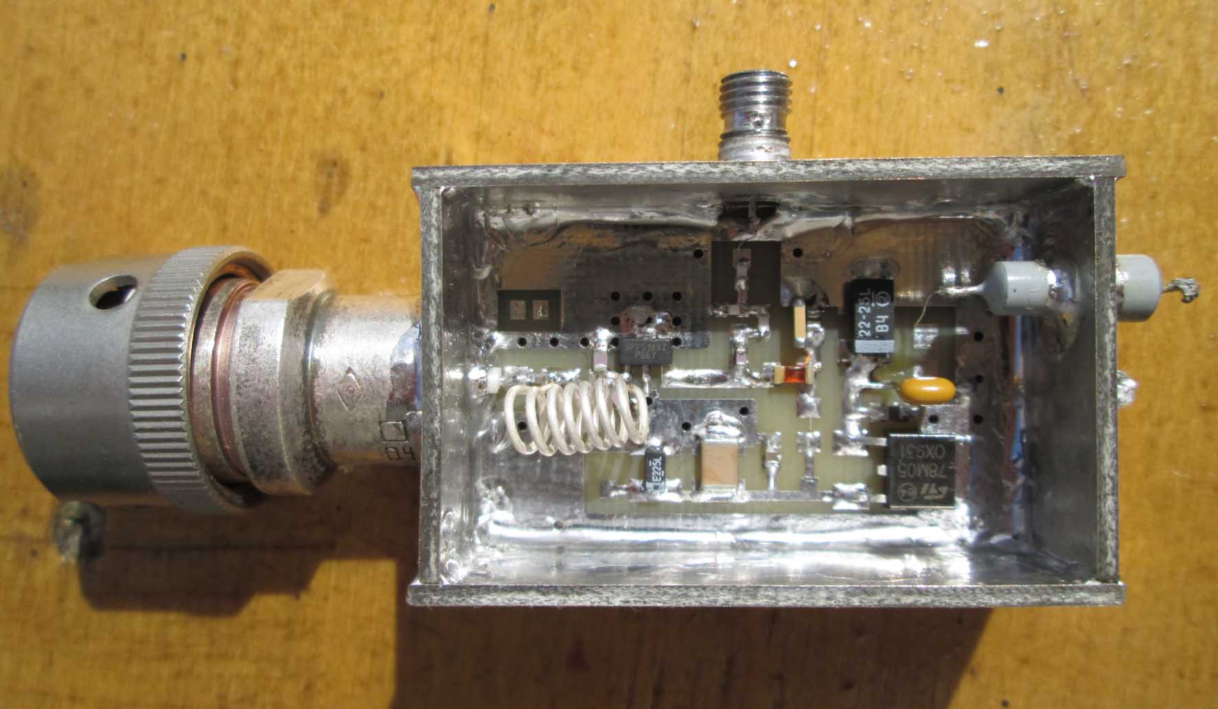

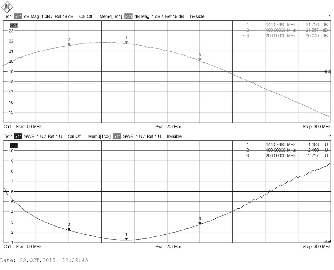

LNA for 144 MHz/ Avia Band & FM BC with SPF5189Z by RF Micro Devices
S21>23 db , NF < 0,7 db
S21 > 20 db , NF < 0,8 db

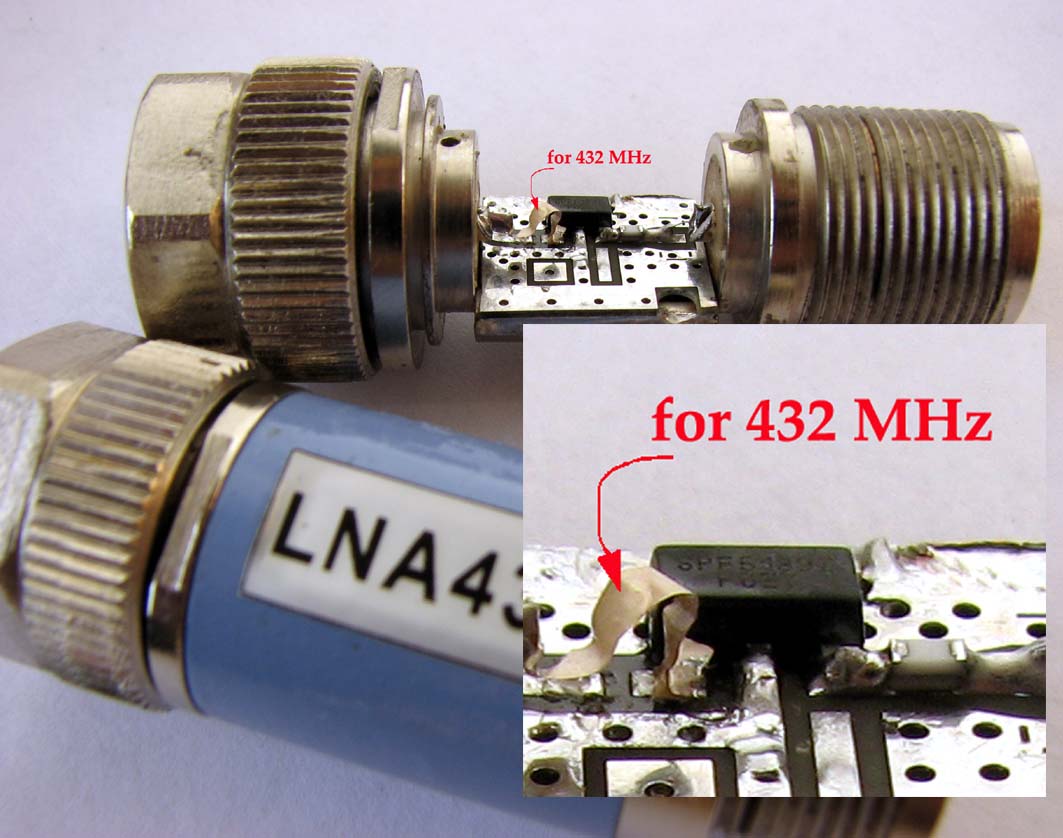

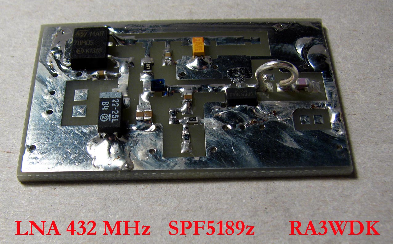

LNA for 432 MHz with SPF5189Z by RF Micro Devices

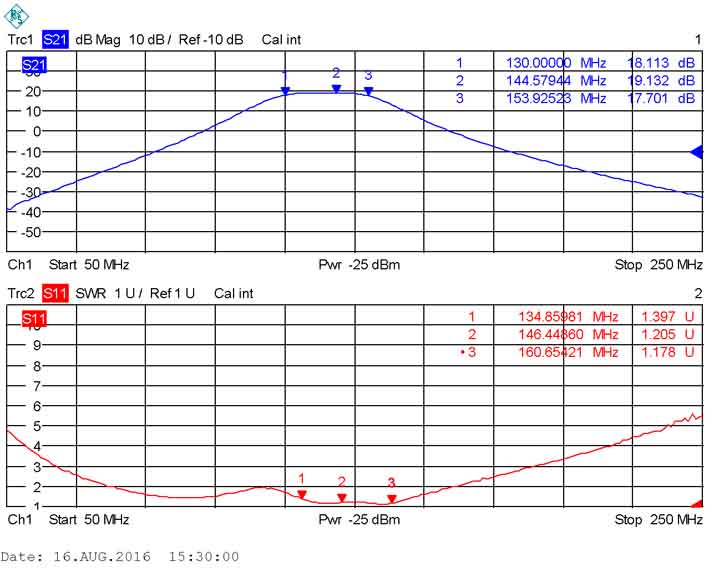

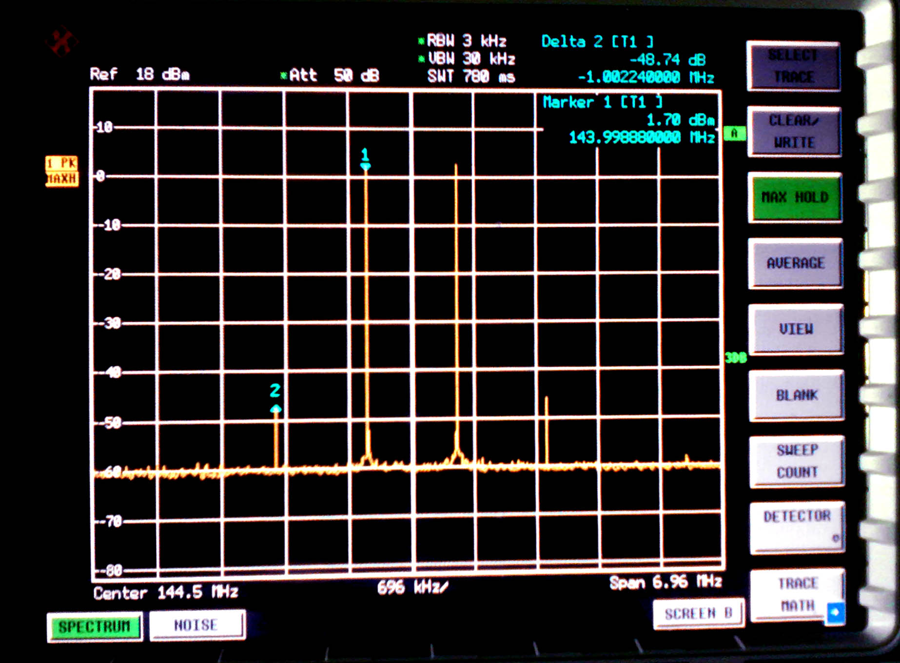

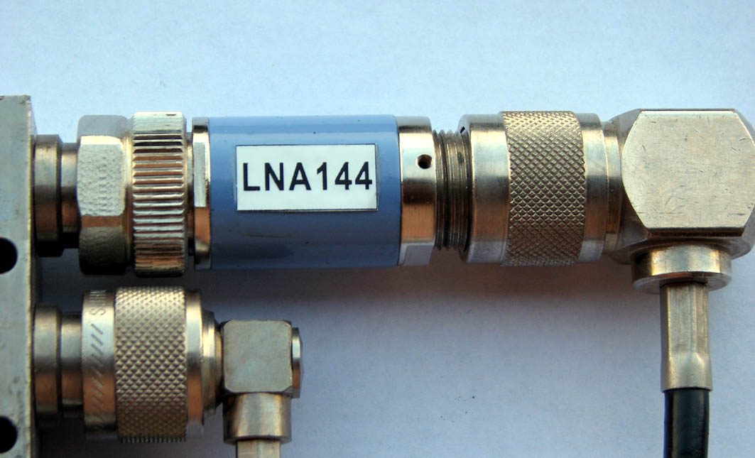

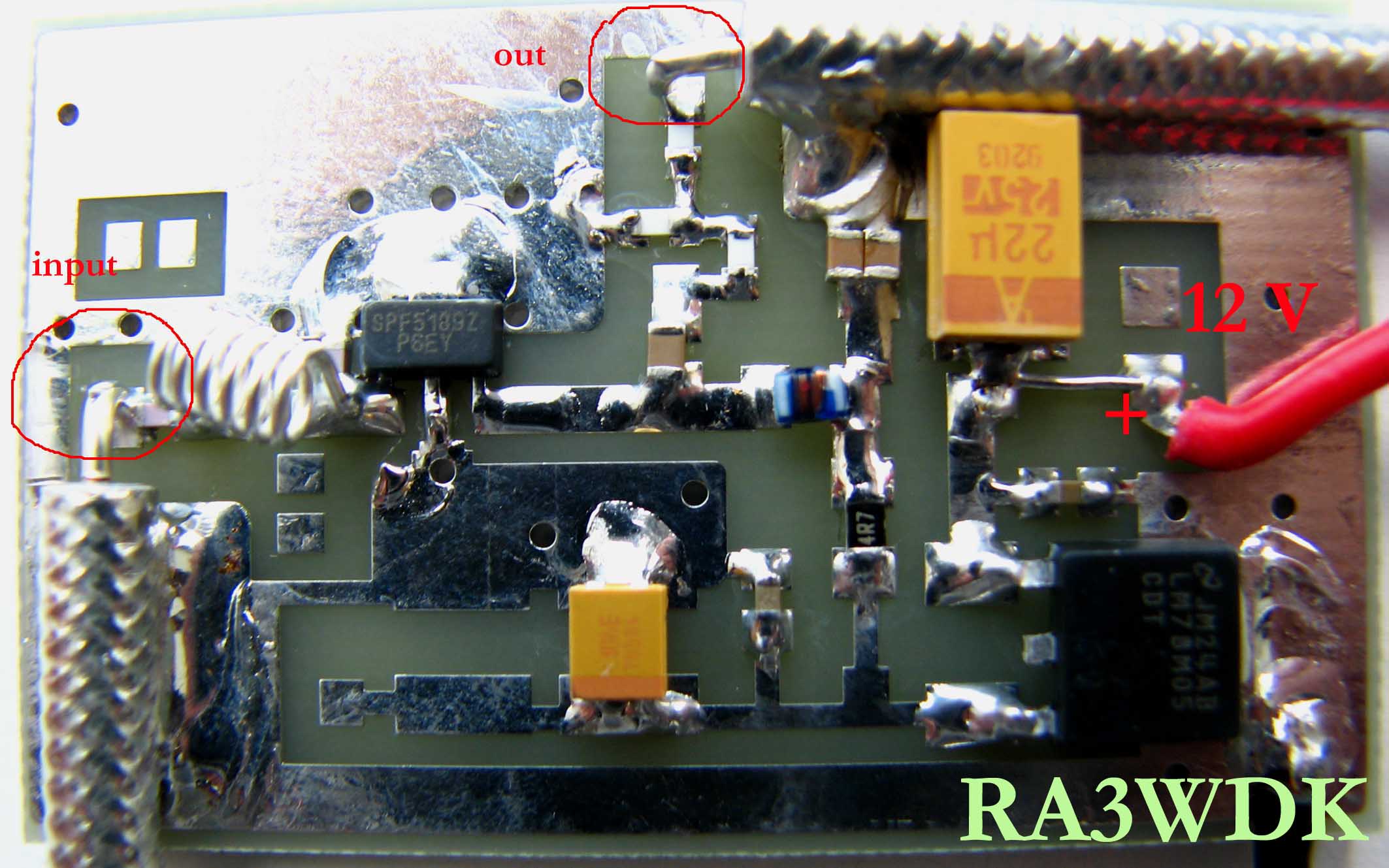

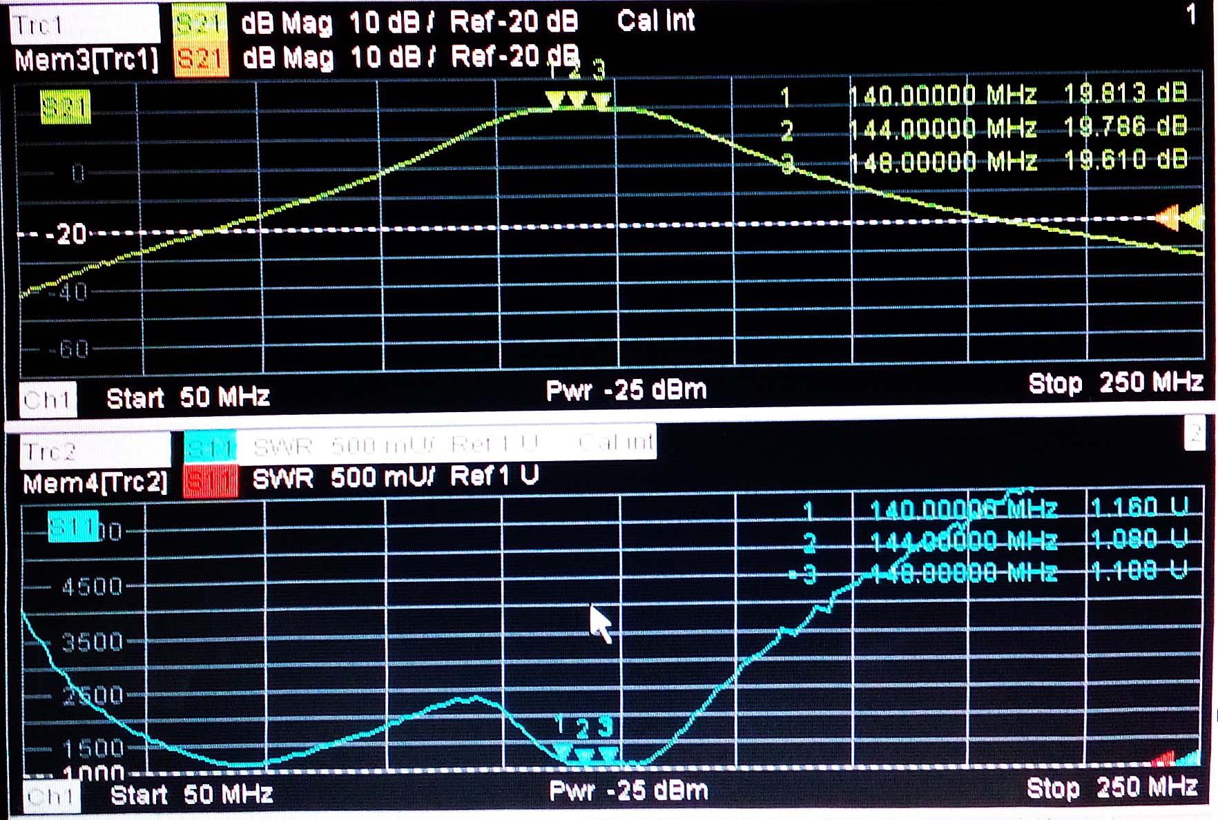

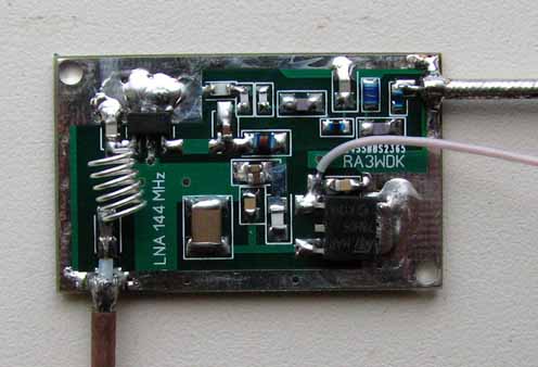

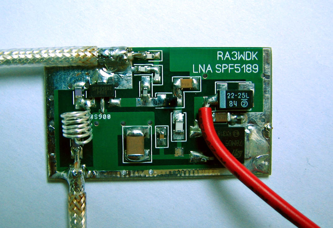

The LNA for 144 MHz with SPF-5189z GaAs pHEMT MMIC from RFMD
Simple construction, no tune, low noise, wide band, high linearity, small size... S21 > 20 db , NF < 0,6 db

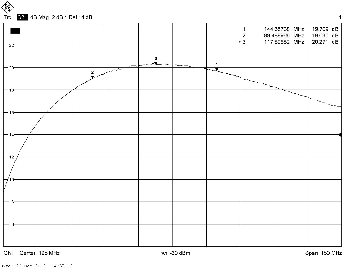

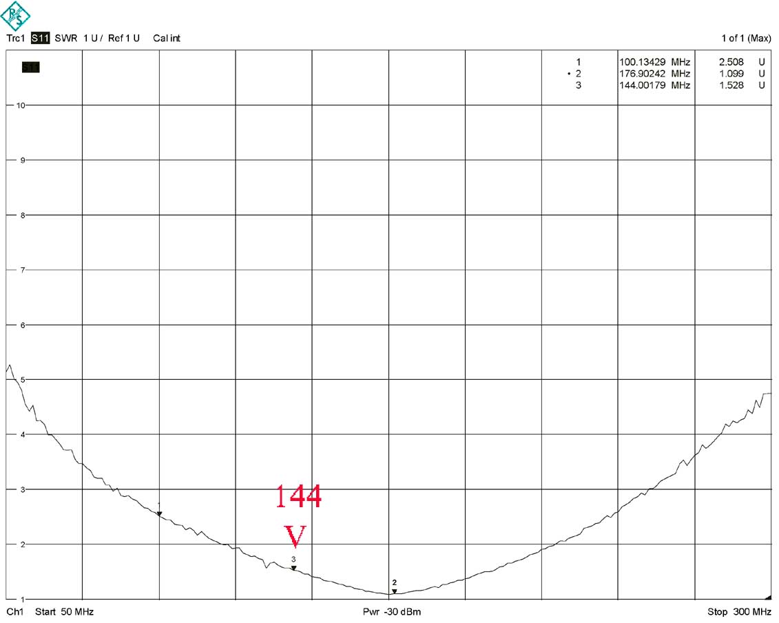

SWR of input for optimal NF

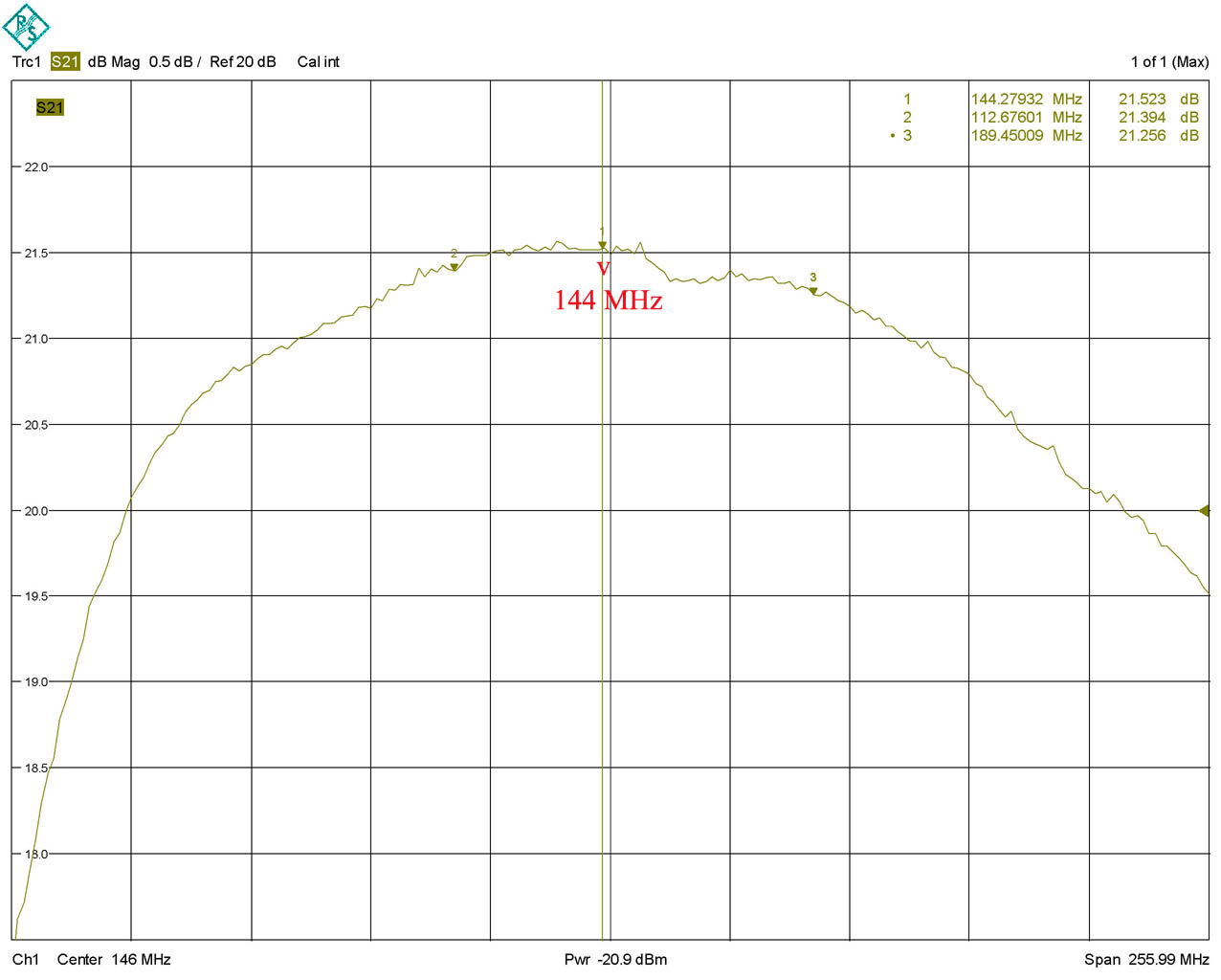

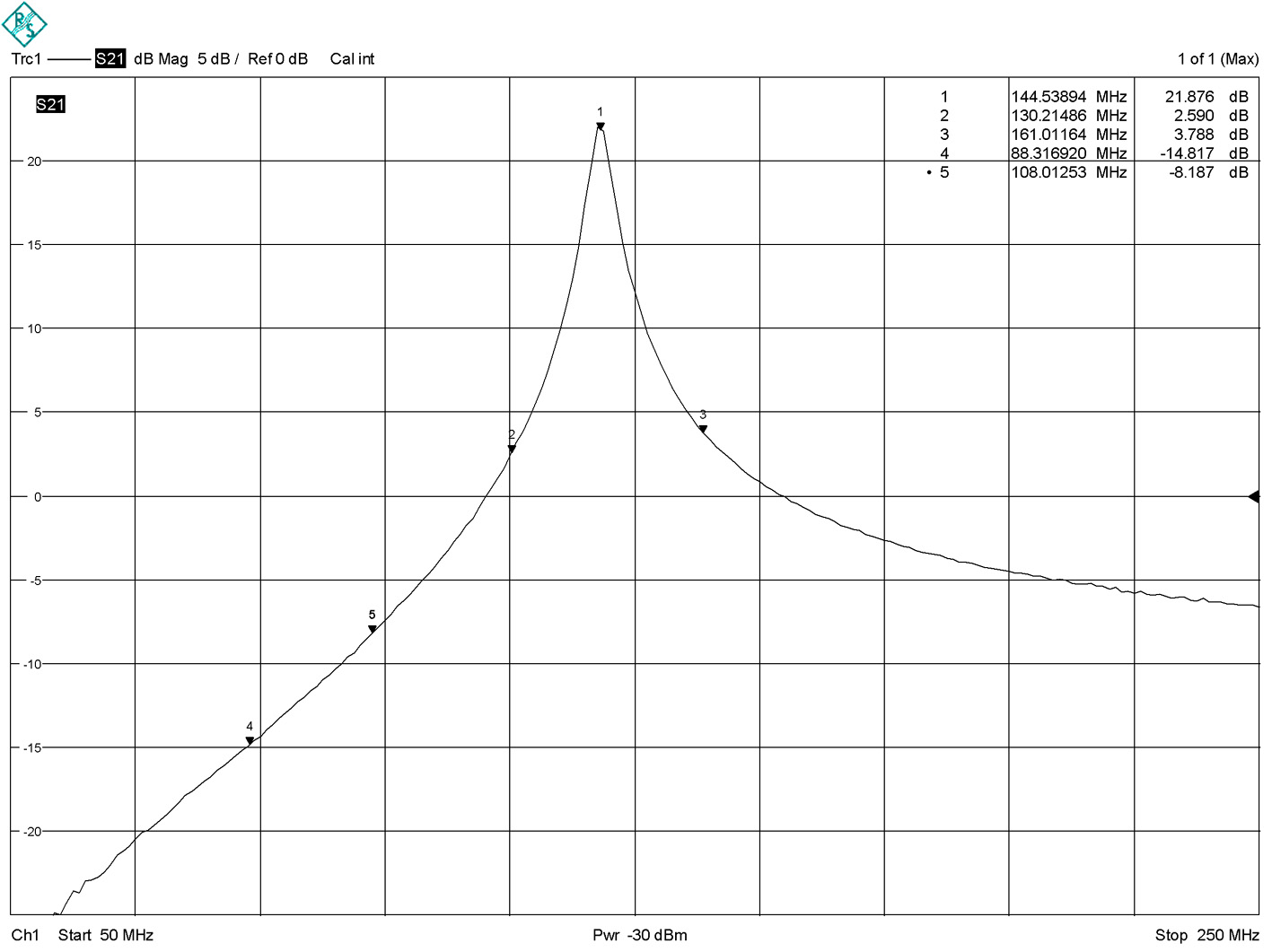

S21 for LNA SPF5189z
(with 5 db ATT in Output of LNA)
Measure IP3(out) about +26 dbm

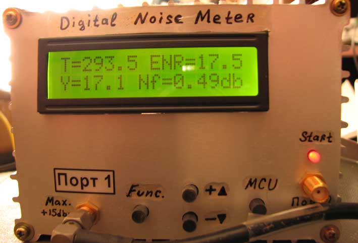

NF measurement

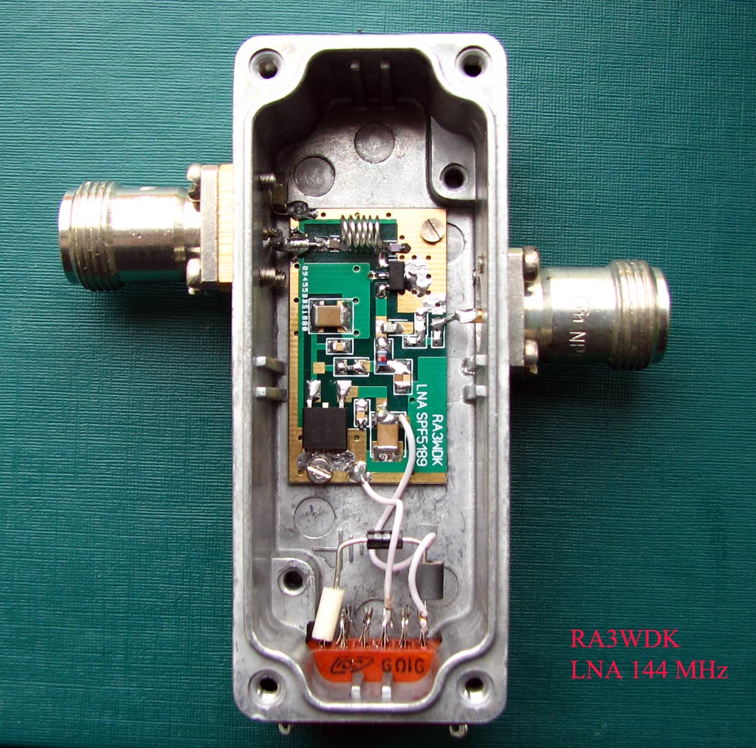

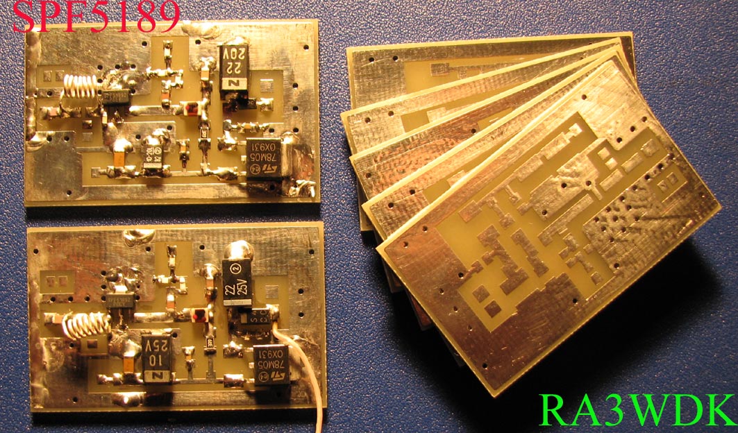

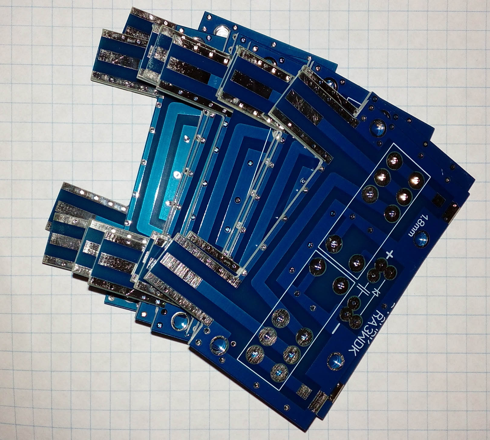

NEW PCB for LNA SPF5189z

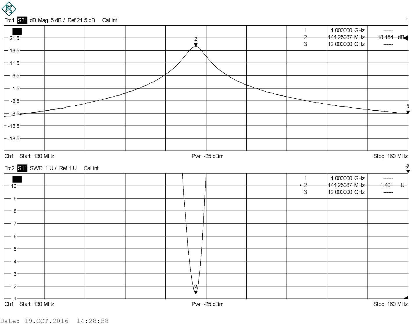

High IP3 LNA 144 MHz with two channel output

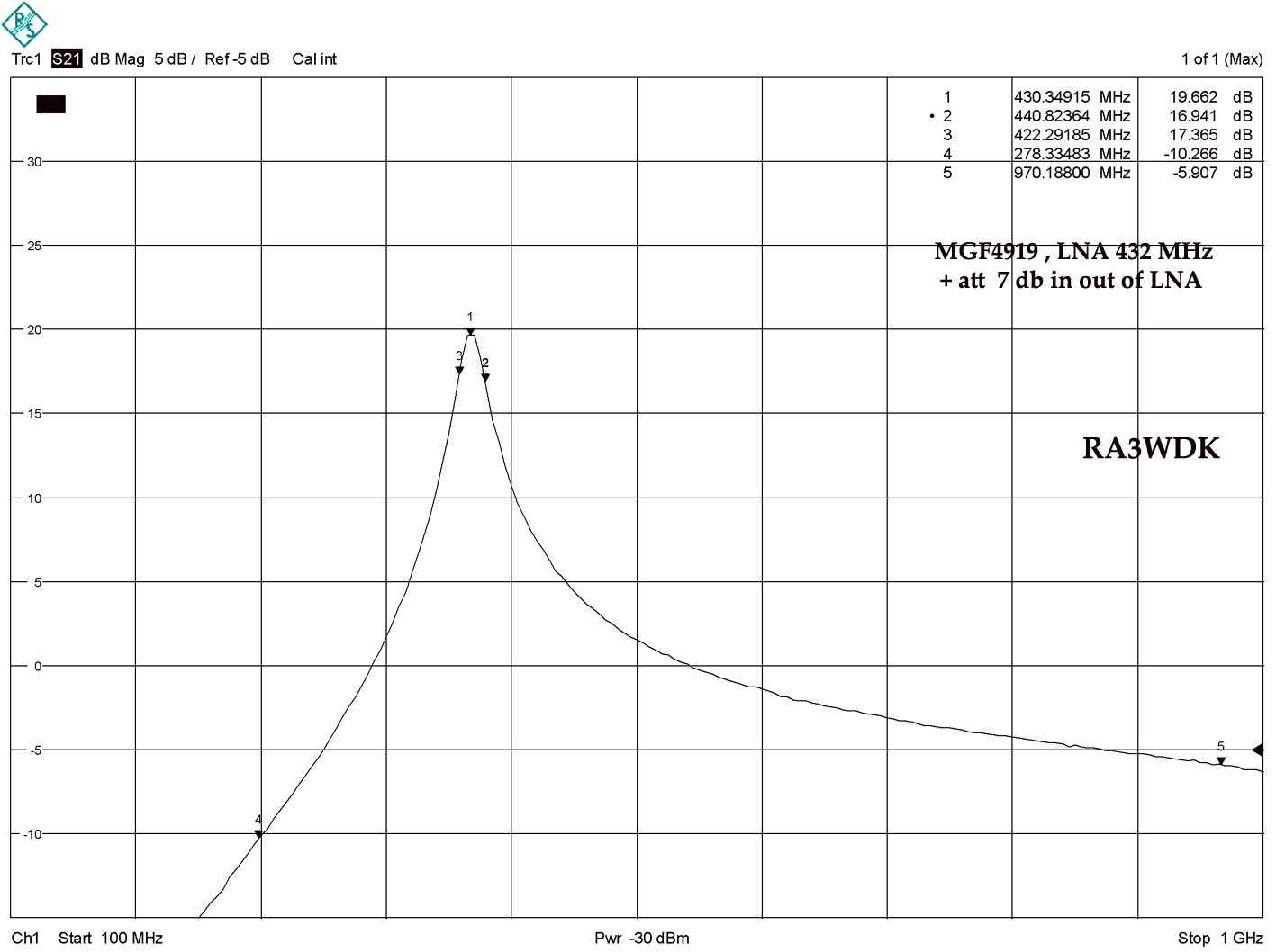

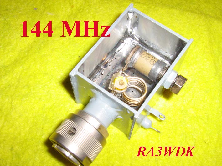

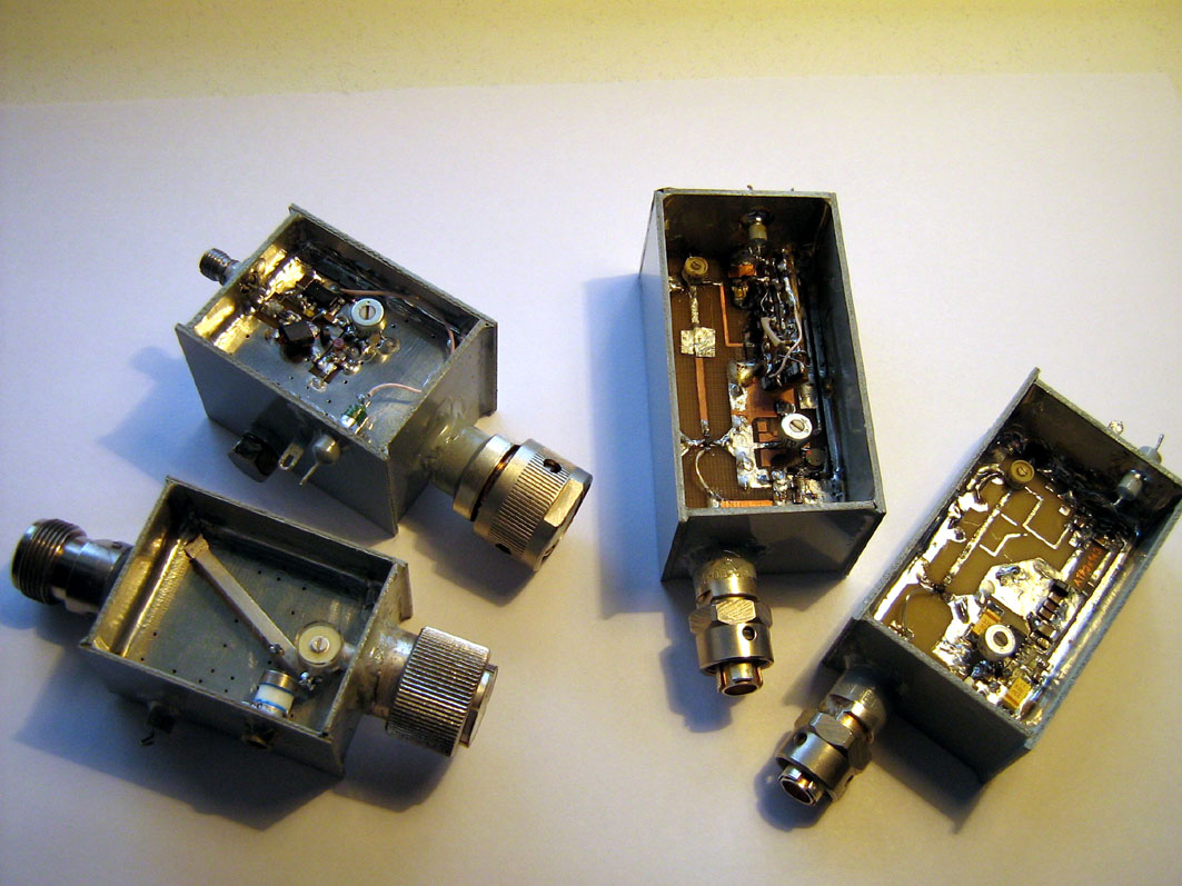

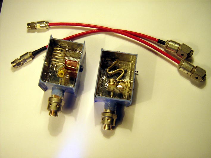

LNA for 144 MHz and 432 MHz (MGF1302, 1303 ,3P325)
S21 of this LNA, norrow band, low Nf ..... "oldschool"
PCB file_144_434 for MGF1302
specification for LNA144 / 432

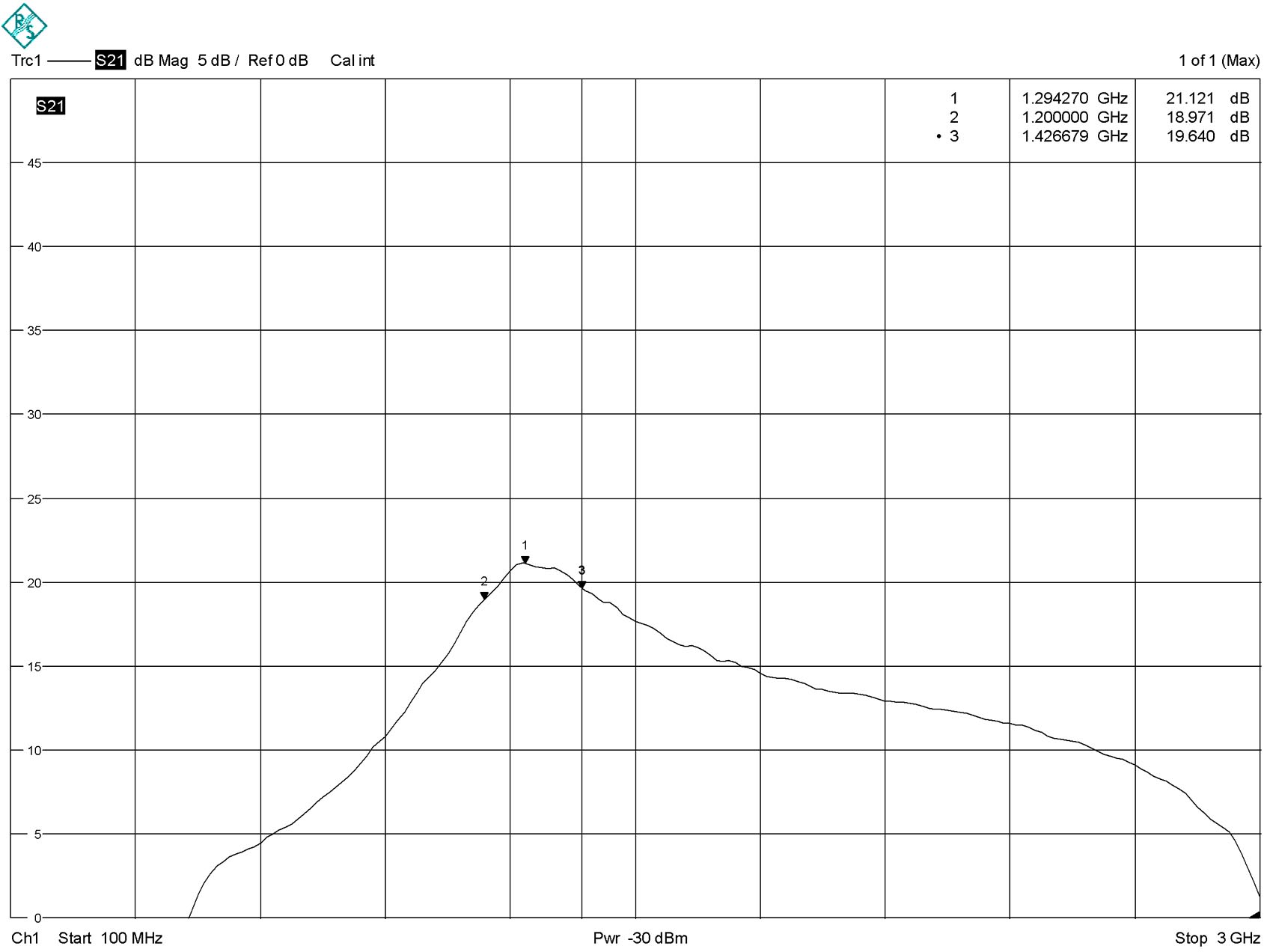

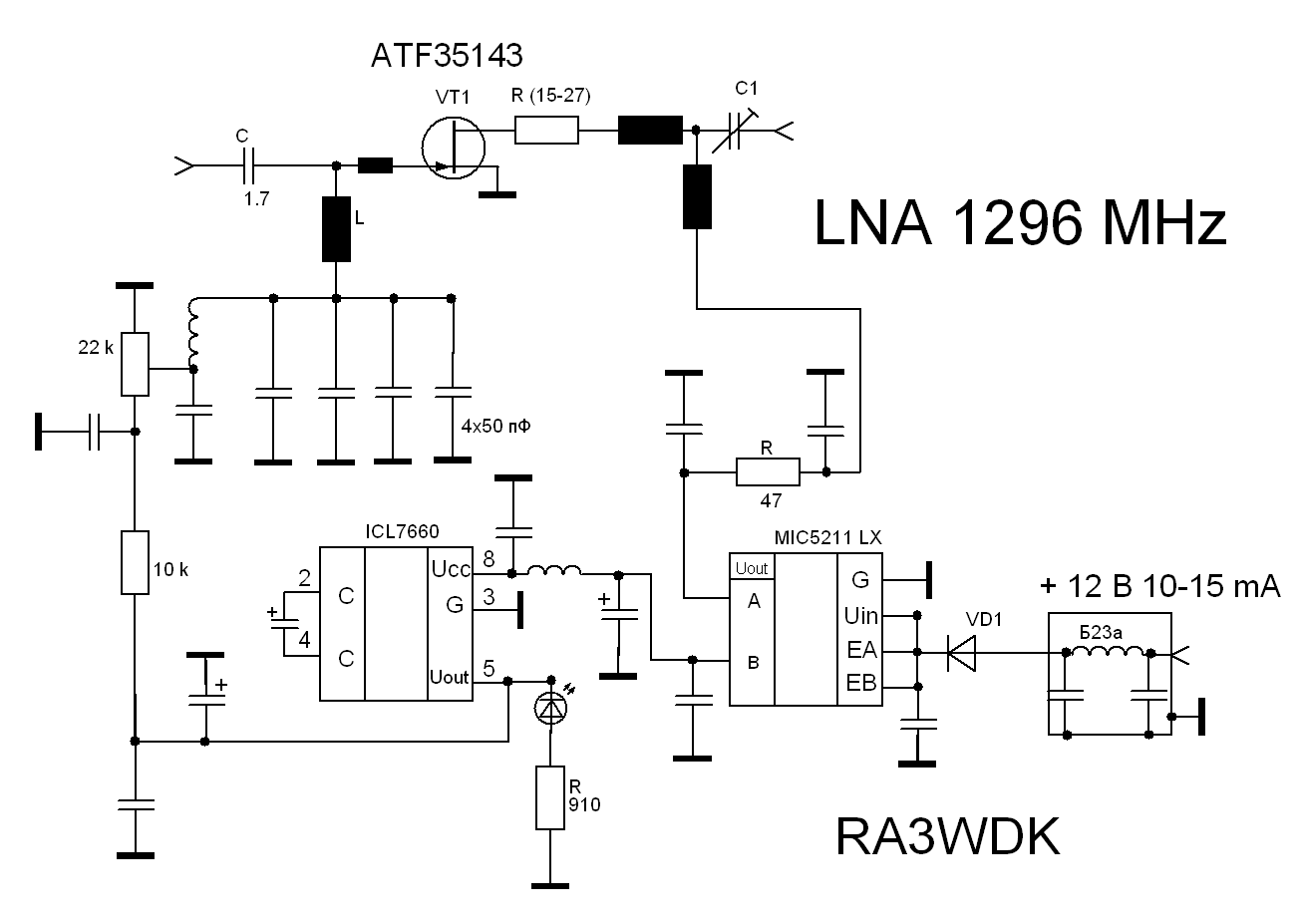

LNA for 1296 MHz (ATF35143)
LNA ATF35143 Measure S21 , Pin -30db

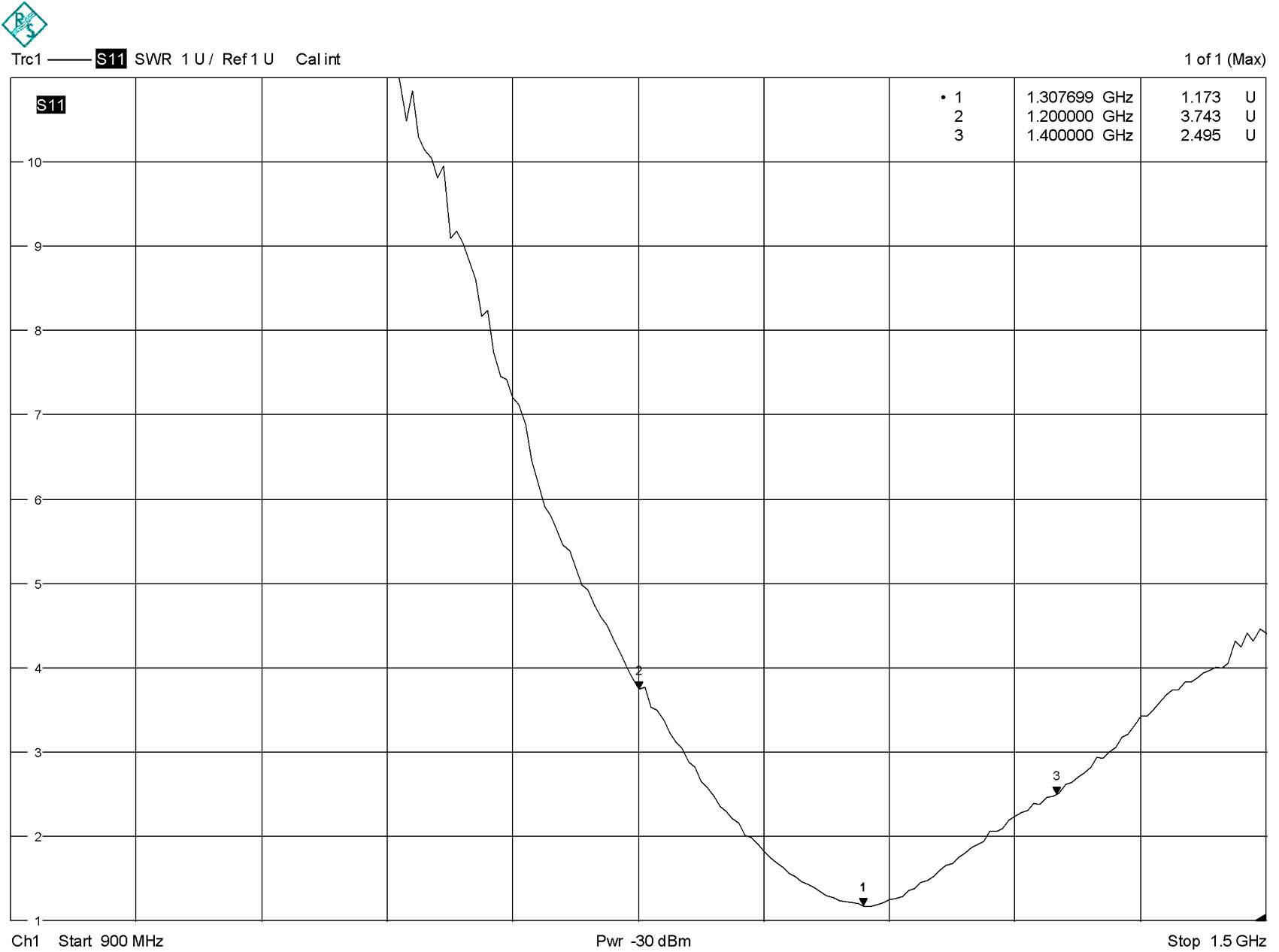

LNA ATF35143 Measure S11 , Pin -30db
PCB file_1296 ATF35143 ( Layout 4)
specification for LNA1296

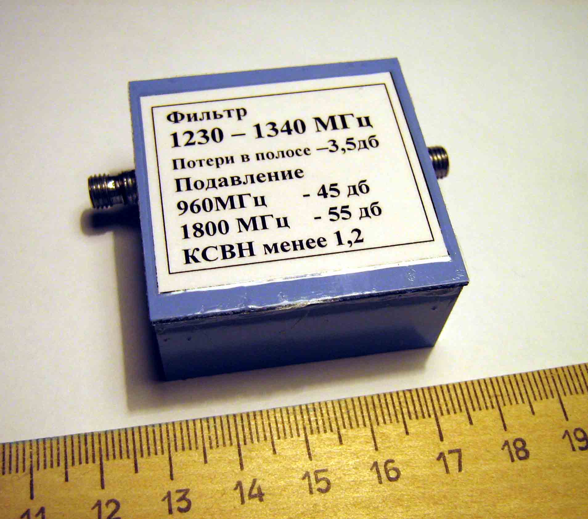

BPF 1296 MHz

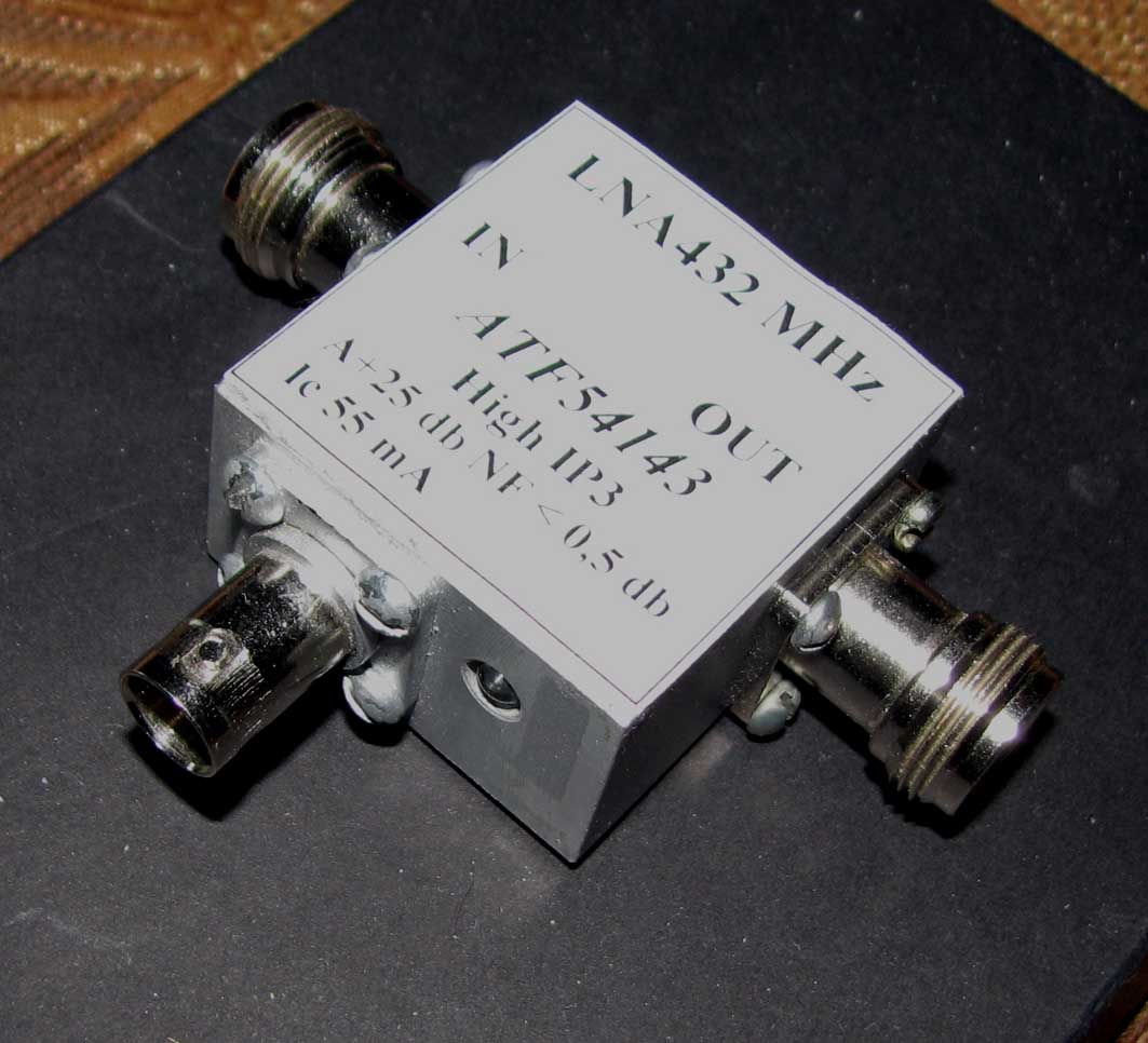

LNA`s for 432 MHz, Nf < 0,5 db, ATF54143

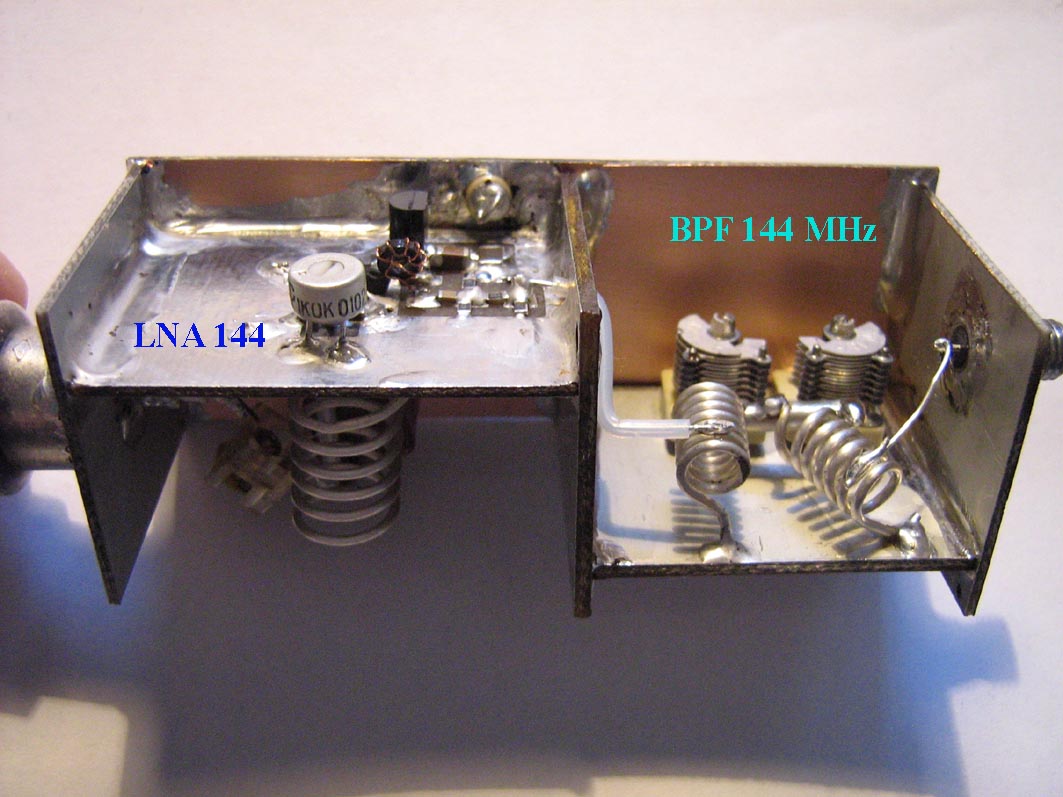

Special LNA + BPF 144 MHz, my old LNA
Photo made without side of case.
This idea - not modern in this time

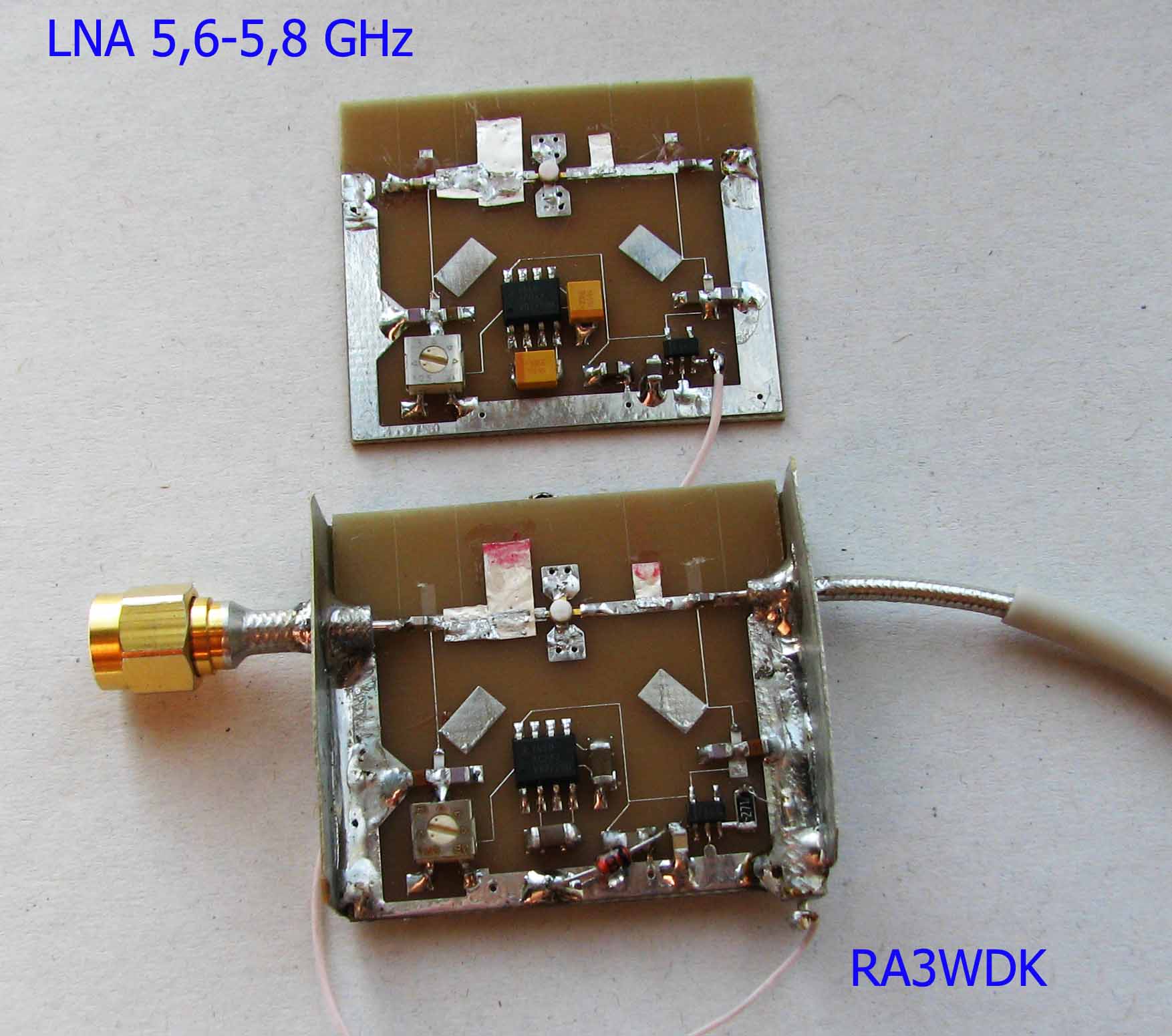

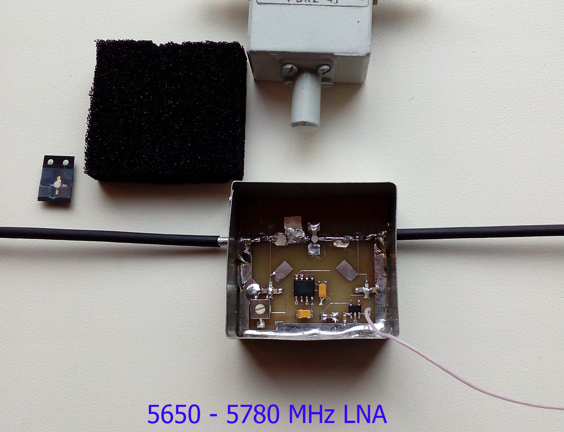

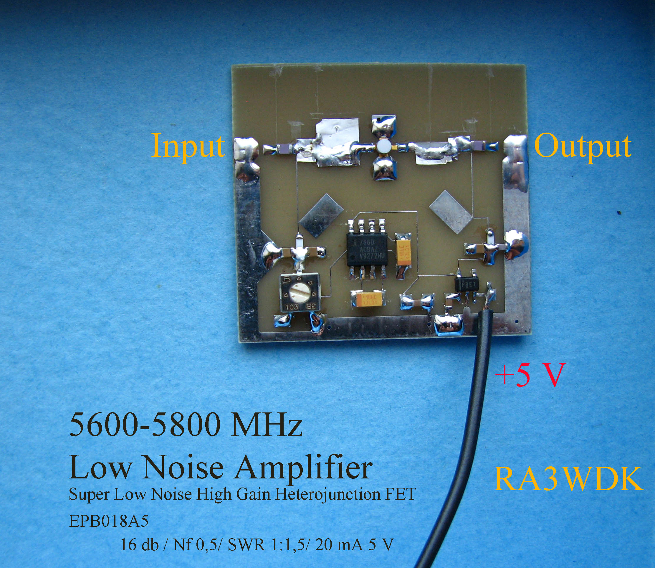

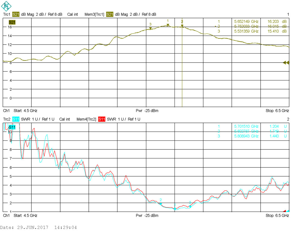

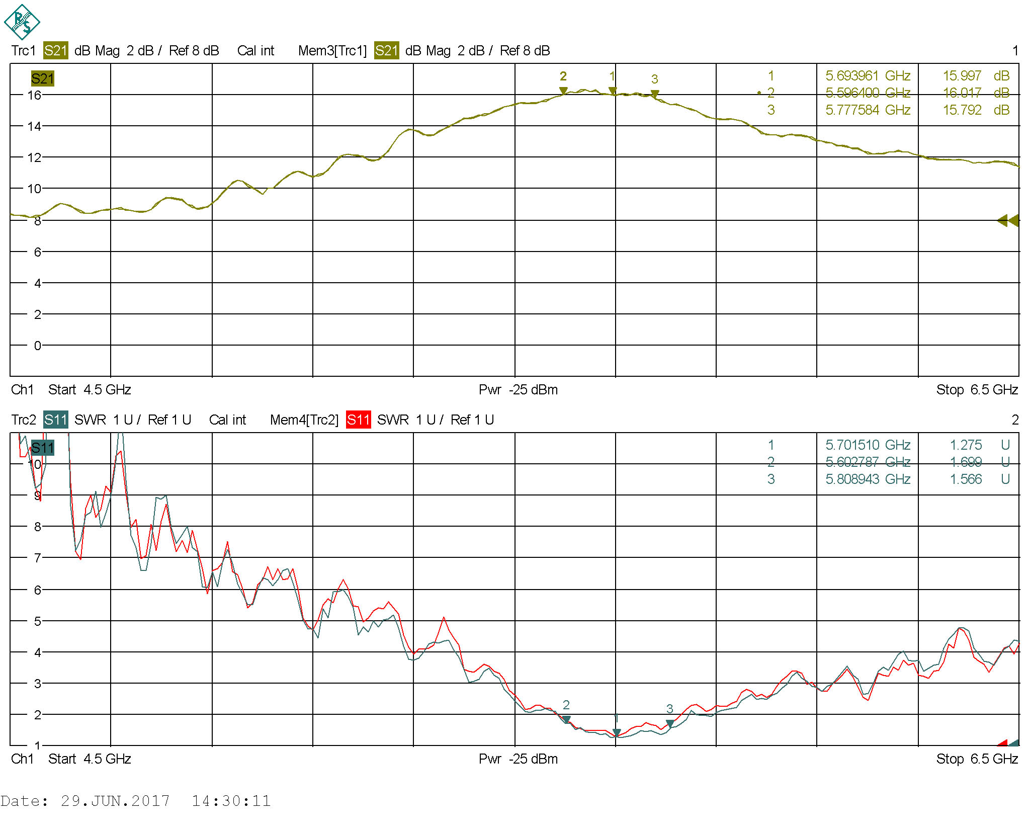

LNA 5,6-5,8 GHz with EPB018A5
LNA # 1
LNA # 2

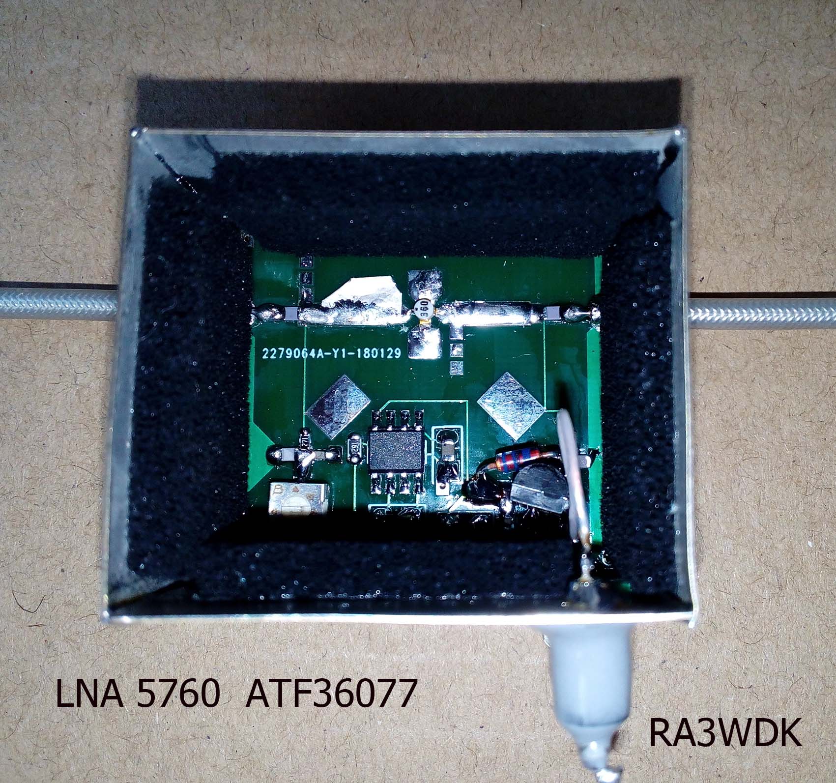

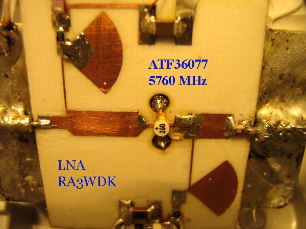

LNA 5760 ATF36077

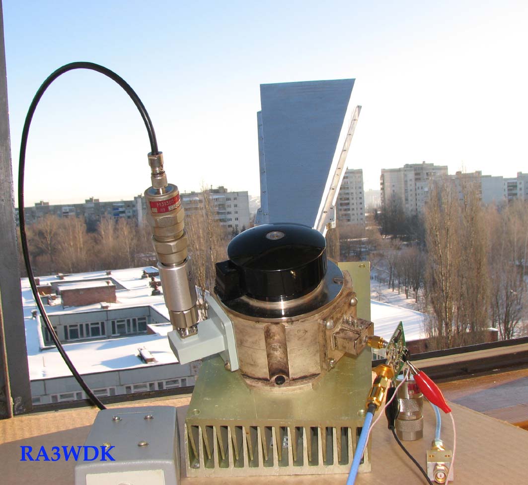

Measurement NF of 1296 MHz system

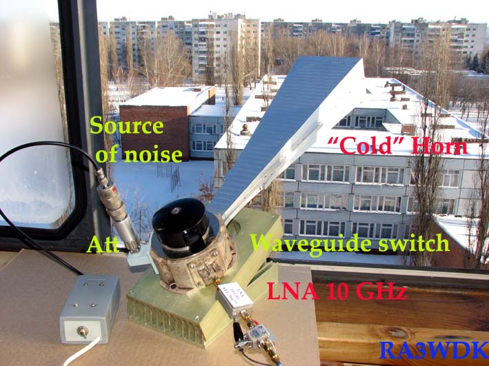

"Cold" Horn for measurement NF of LNA on 5,7 GHz and 10 GHz
5,7 GHz

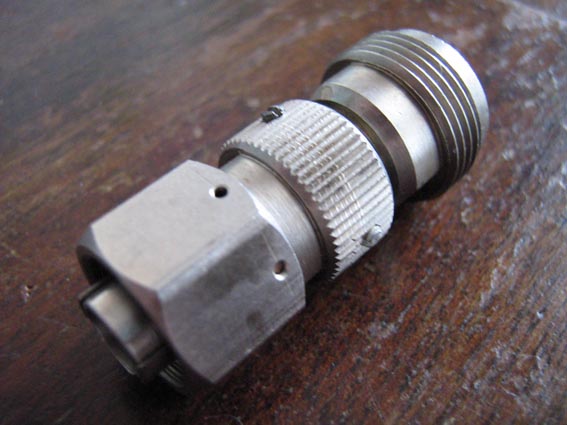

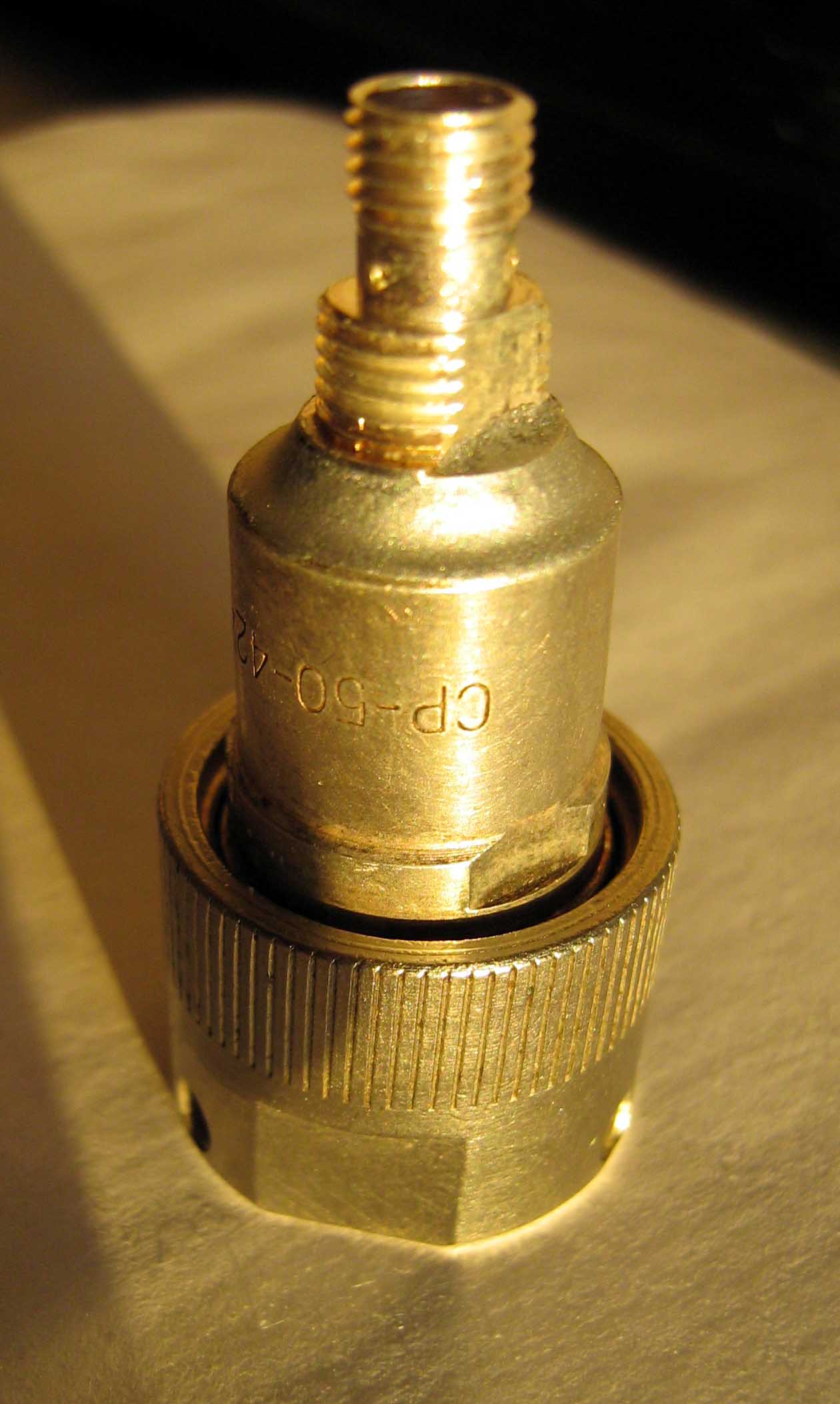

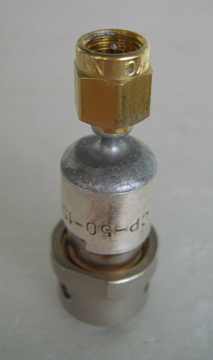

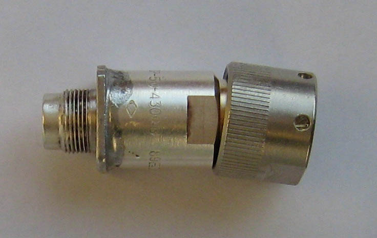

Homebrew CP-50-155 to N connector
SMA to N
CP-50-155 to N
