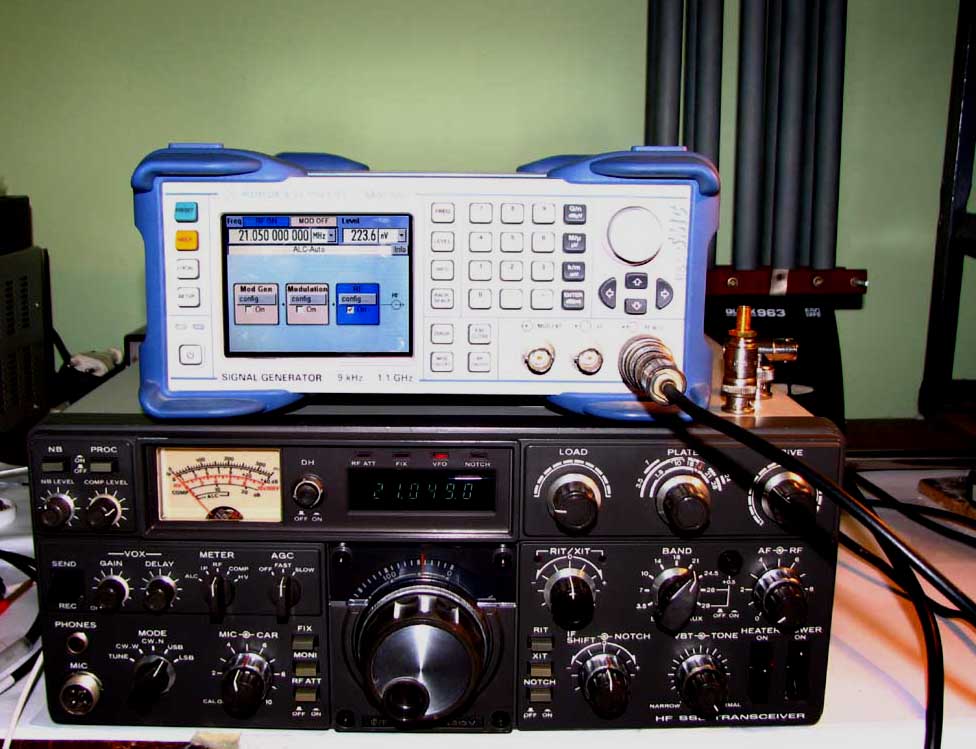

Some time ago I bought legendary TS 830 and narrow CW 270 Hz filter. I checked sensitivity and some other performance of "old machine". It was OK !

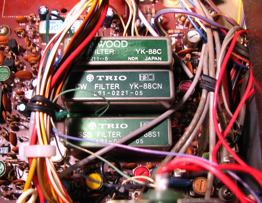

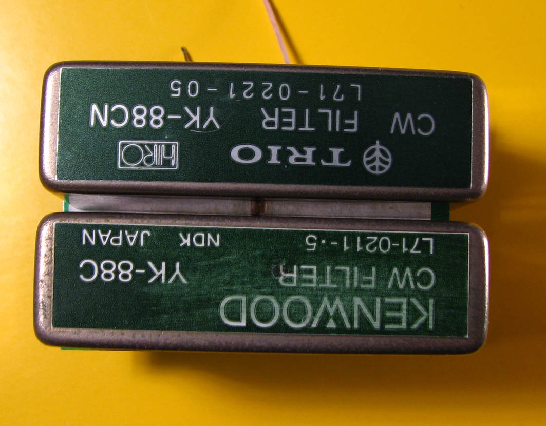

  Second CW filter in 1st IF of TS-830

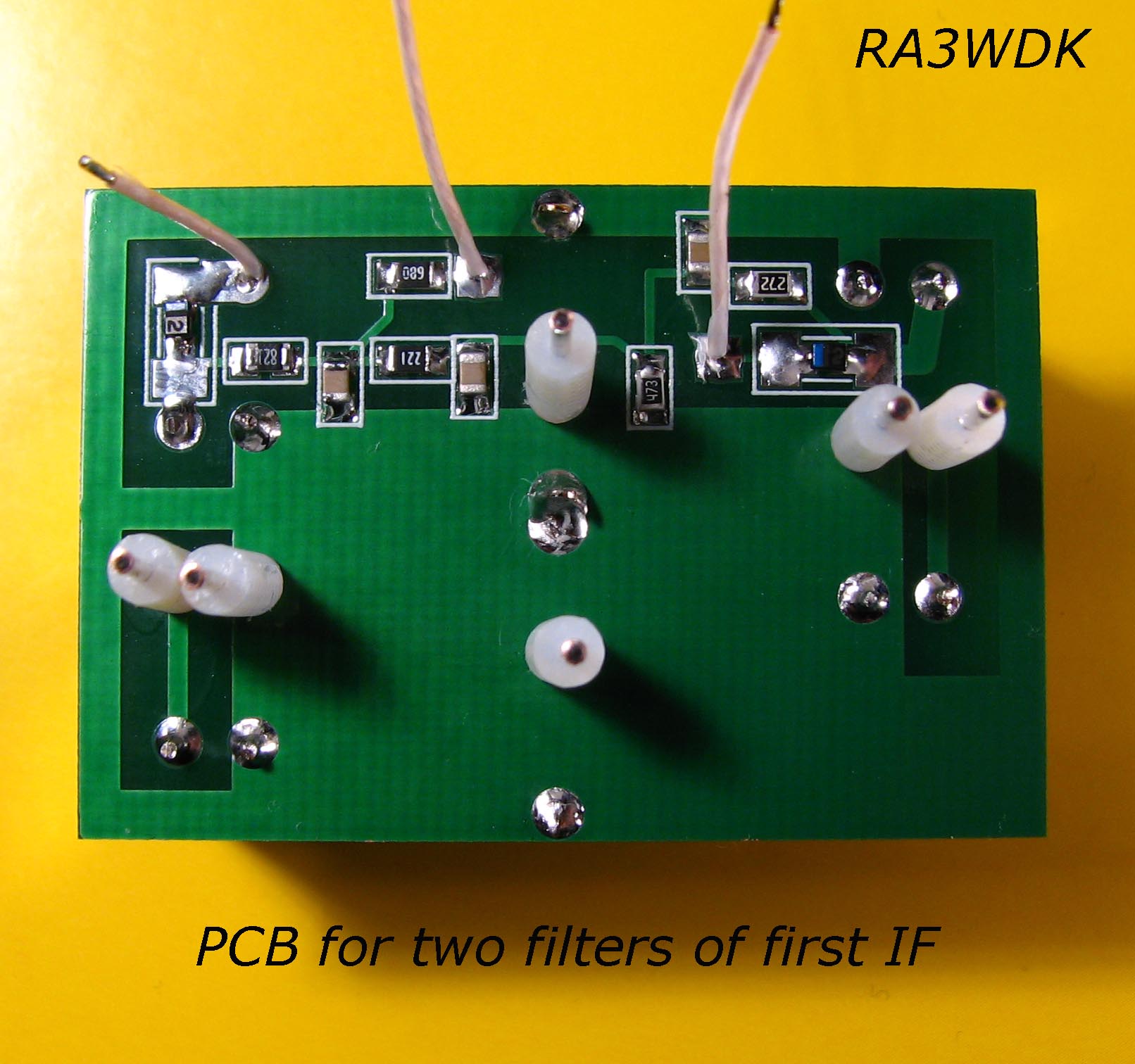

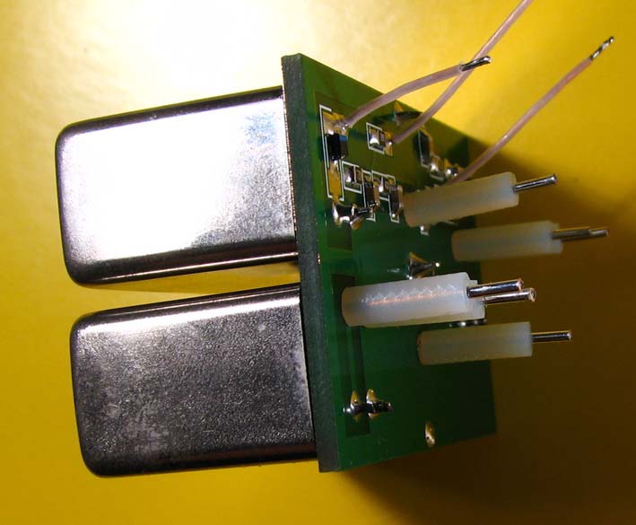

YK-88C 500Hz and YK-88CN is good filters for 1st IF of TS-830, but we can not use both filters. Why ? I made small board with place for two filters.
I re-wired the DH (I did not use digital hold) button for choose the second filter on the board. I can use filter with bandwidth 500 Hz or 270 Hz and check filter with 600 Ohm resistor (impedance of input/output filter).
Low insertion loss and big isolation between filters !
I bought YG-455Ñ

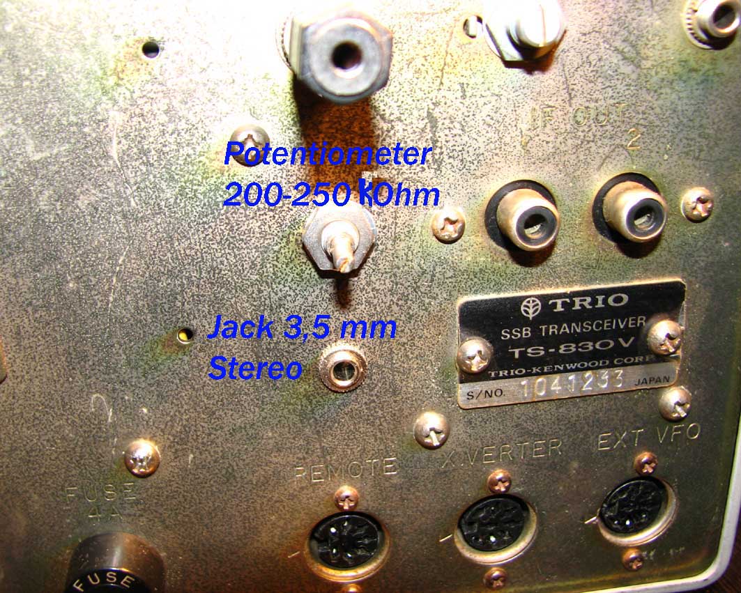

I used potentiometer "VOX Delay" (250k) for Speed control of key and set new potentiometer for "VOX Delay" on back panel.
Shielding the cables for "Speed control" potentiometer on front panel of TS-830 is recommended but may not be required. If you use shielded cable, you can grounded it only in PCB of key. The PCB of key can be set near IF unit or transformer. Jack 3,5 mm and potentiometer "VOX Delay" mounted to back panel. Supply 12 v for CW key got from pin# 12 of AF UNIT (X49-1140-00).

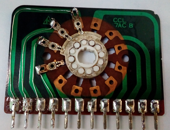

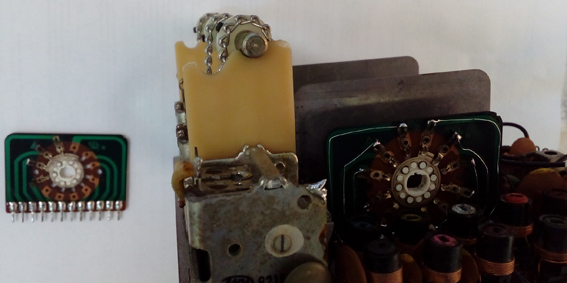

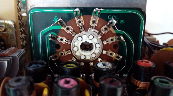

How you can repair waffer switch if you have different power on any band or problem with RX
