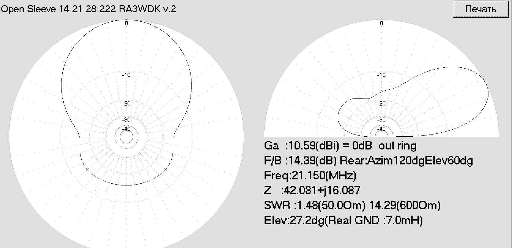

Experimental Tri Band yagi for 14/21/28 MHz Bands
- Turning radius only 4,5 m
- Boom only 3,4 m
- Gain on 14 MHz 6,4 dBi
- Gain on 21 MHz 5,8 dBi
- Gain on 28 MHz 6 dBi
- Gain about 11 dBi for setting 10 m height
MMANA Model WDK222.maa
Radiation pattern of TriBander on 14 MHz for optimal height 10 m
Radiation pattern of TriBander on 21 MHz for optimal height 7 m
Radiation pattern of TriBander on 28 MHz for optimal height 5 m

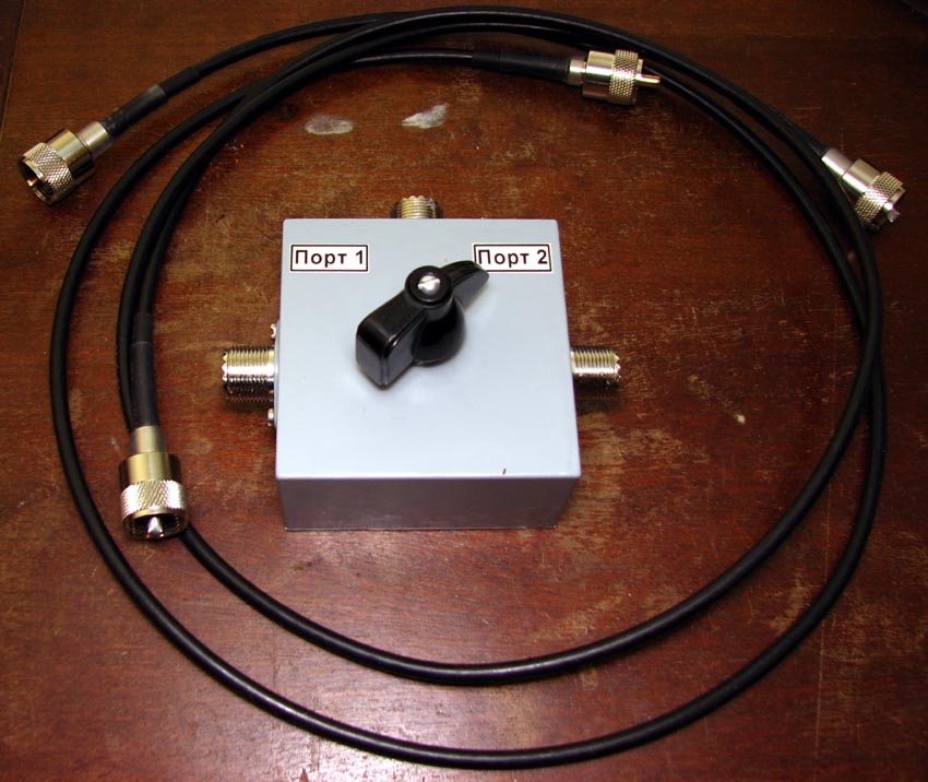

" If you want a thing well done, do it yourself " .... Doing RF switch !
Antenna switch with antenna selection for each RX / TX operation mode

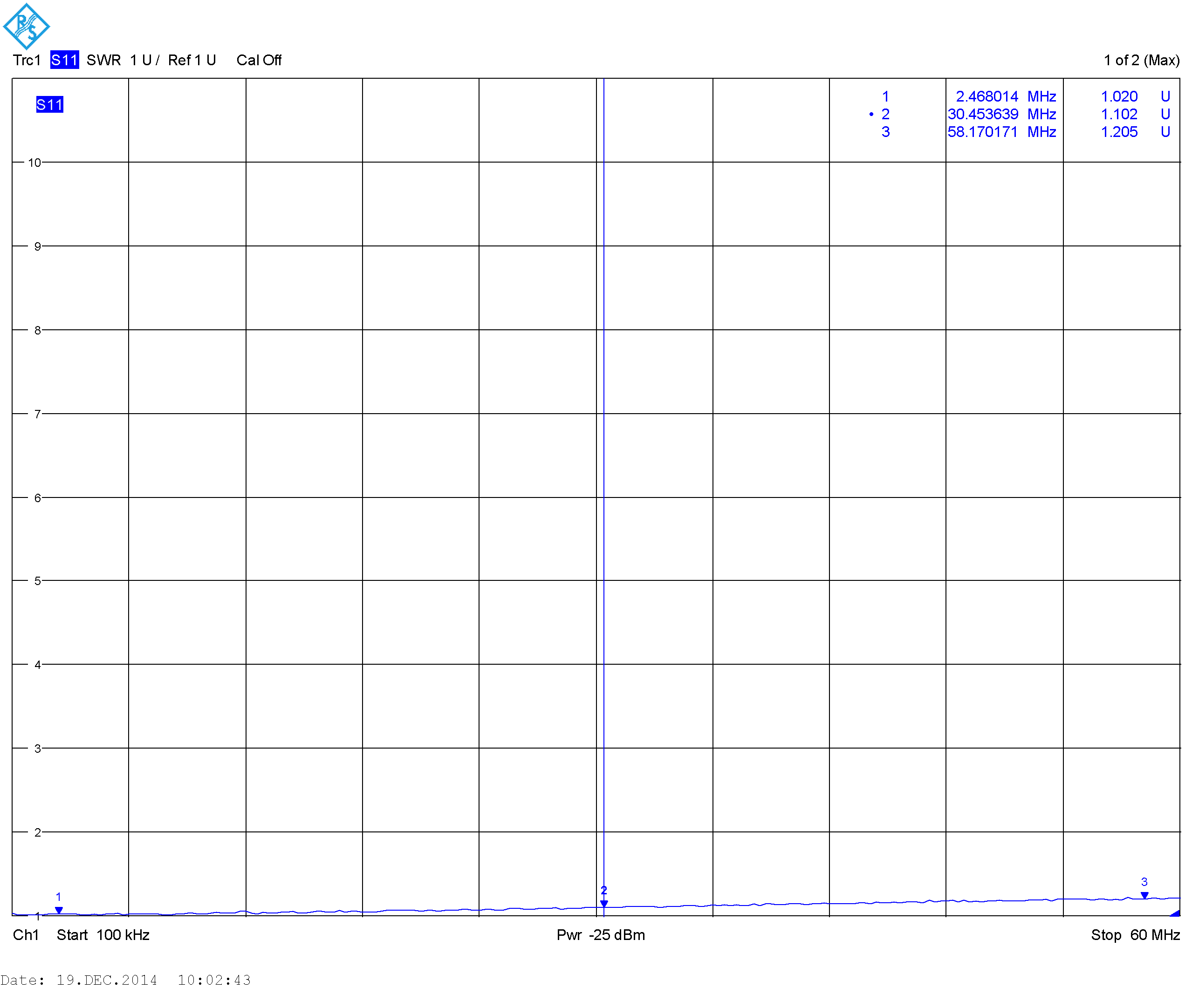

SWR
Insertion loss between Port - Input
Insertion loss between Port - Port

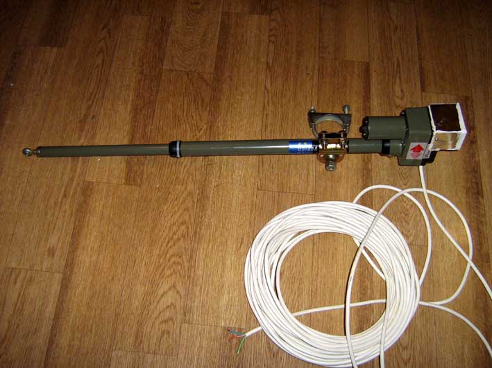

My Yagi Antenna Construction with Elevation for EME
Modification mini-actuator 12`` Golden Inerstar
More info about actuators : www.qsl.net/sv1bsx/actuator/actuator.html
(This page will try to inform you of the actuator's secrets) Thanks SV1BSX
My simple idea, but heavy-duty for elevation system :
Bolt diam. 14 mm ! Steel plate 4 mm !
90 mm homebrew bearing wishout rollers !
.... my system to put on weight about 2,5 kg

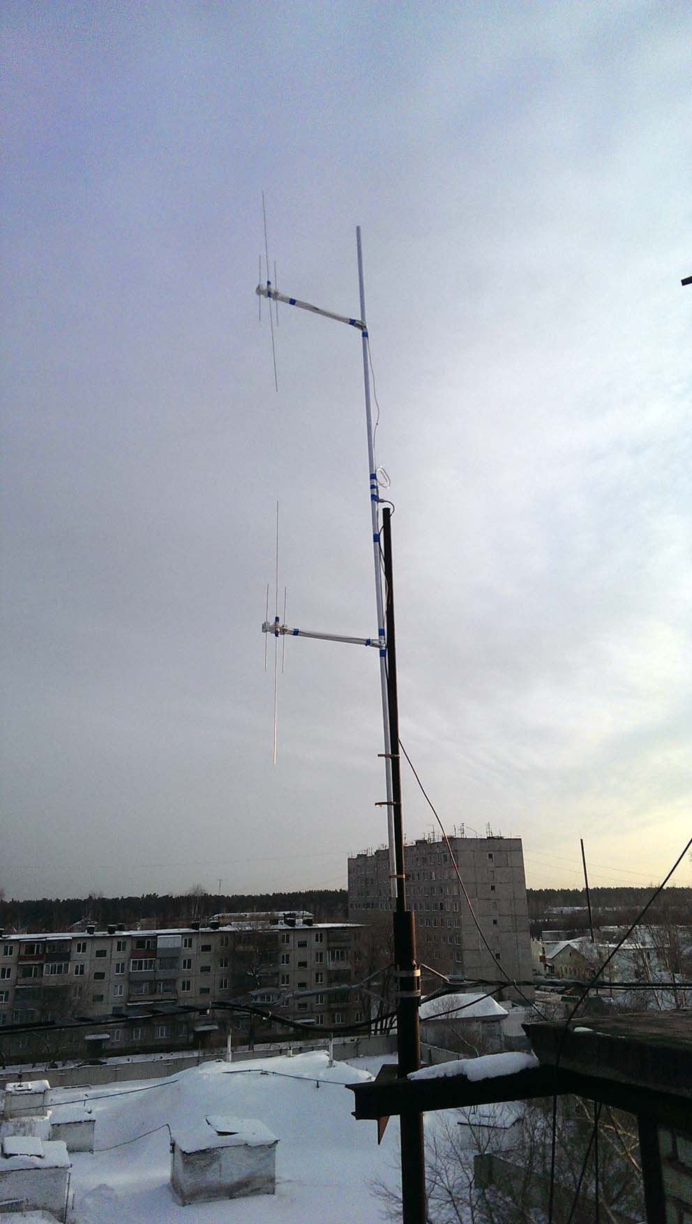

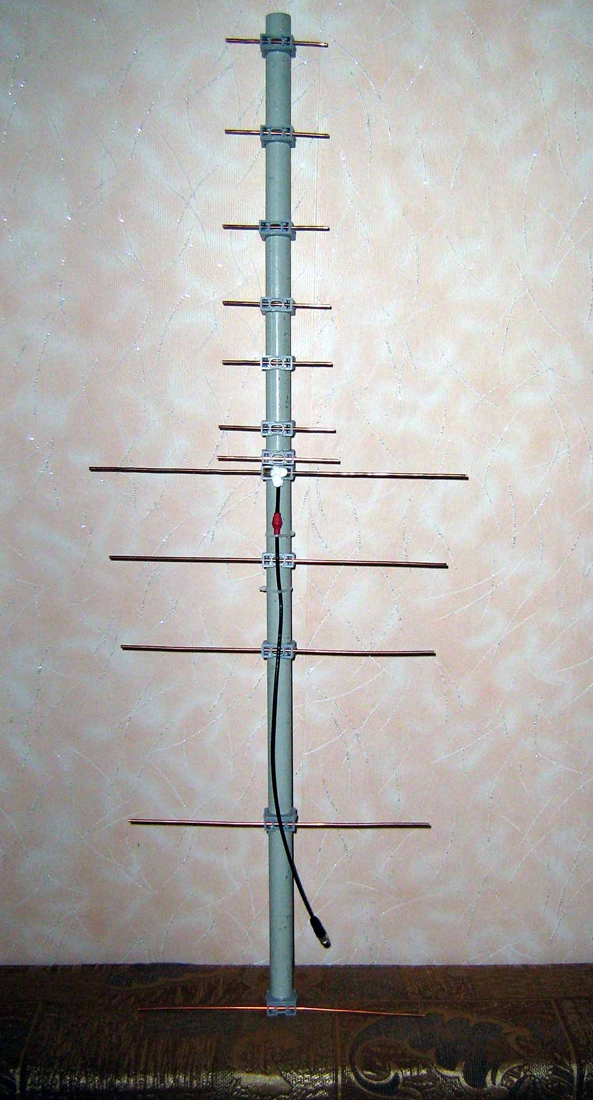

Duble Band antenna for FM , 145 and 433 MHz , only 1 coaxial feeder 50 Om
In my new QTH (2004 year) i made very simple and very cheap antenna (for joke has been spend 2 $ for making antenna) for 2 Band -144+432 MHz
You can download antFM.zip : contructions , SWR , MMANA file model. Many Ham use this antenna in Russia and Ukraine with good result for local and Tropo QSO . Easy constructions and good gain : 2,8 dbd in 2 meter band and 5,2 dbd in 70 cm band. I used this antenna for SAT QSO via VO52 with good result .

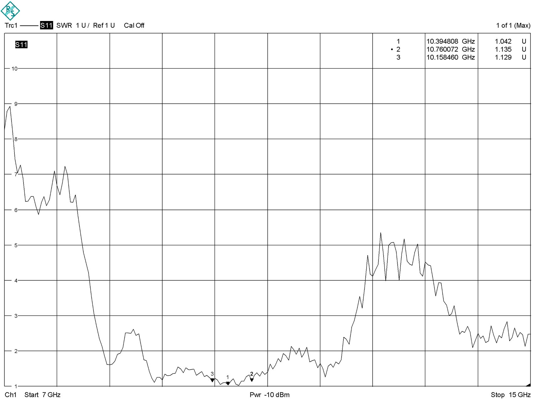

Horn for 10 GHz with angle of 110 degrees for illuminating Dish F/D 0,35-0,5
Description of S11 for horn with angle of 110 degrees:
Feed horn 10368 MHz , SWR <1.1

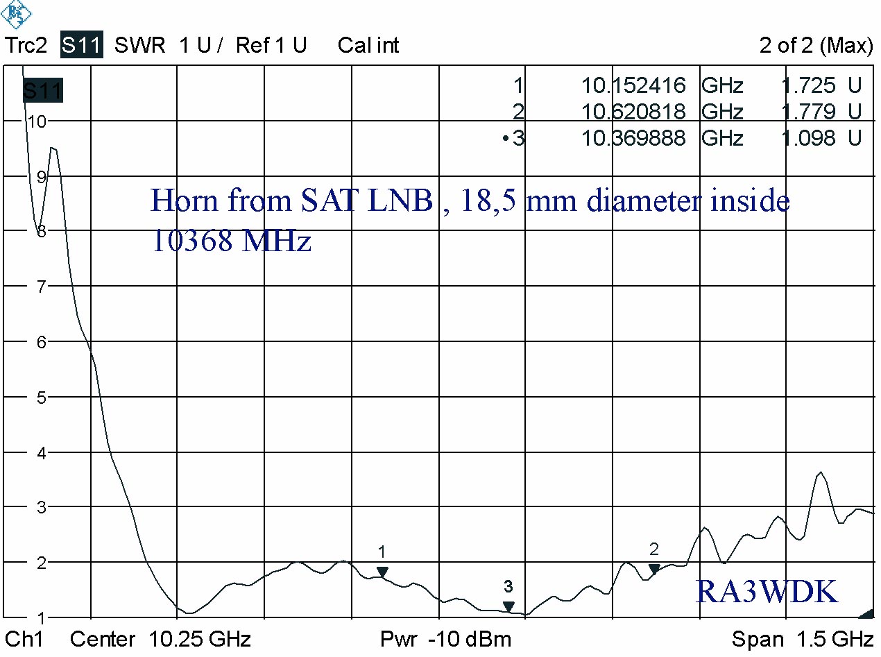

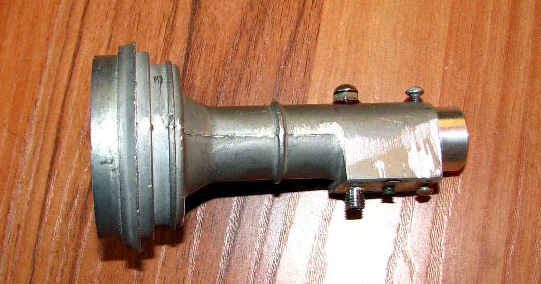

Modification horn for TV SAT dish in 10368 MHz band
Increase in internal diameter to 20 mm !!!
Horn for F/D 0,6-0,7
Modification Horn from SAT LNB - increase diameter to 18,5 ìì inside

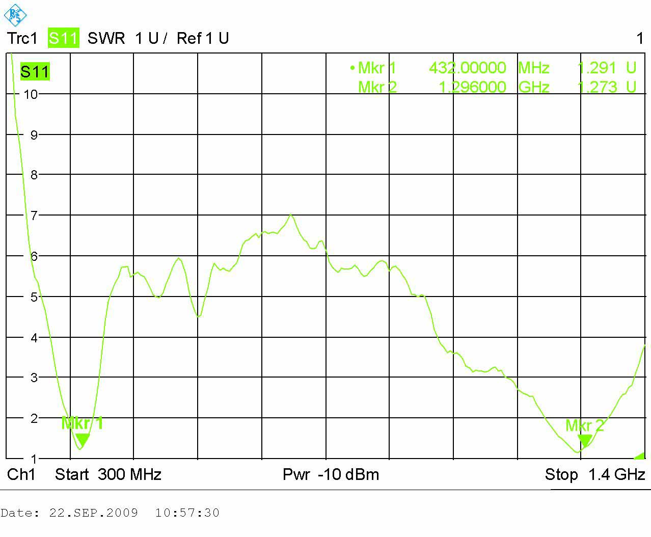

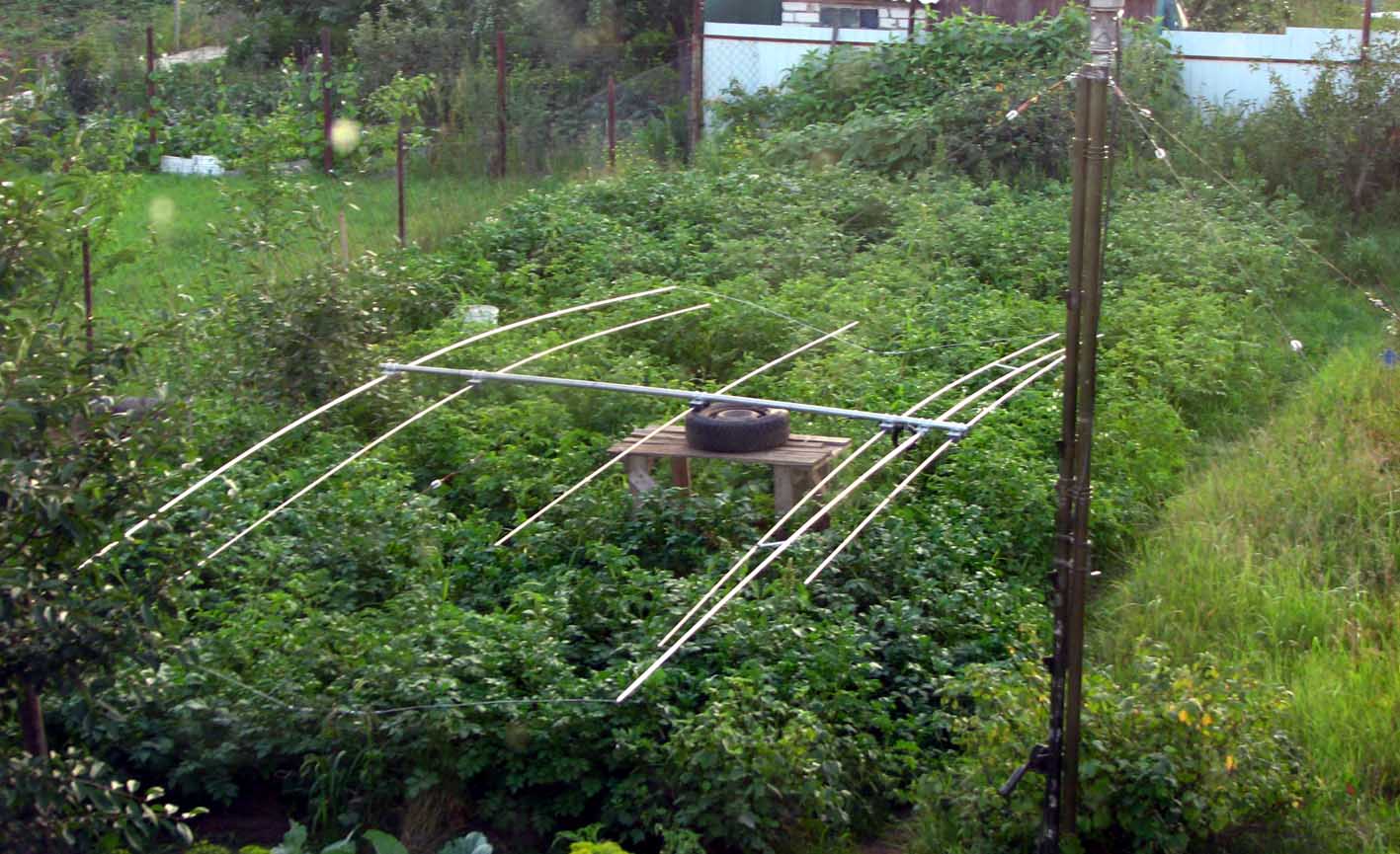

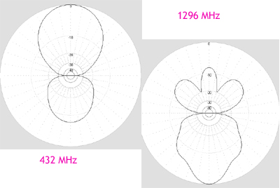

My proect micro yagi in sungle boom for 432 MHz and 1296 MHz band ("LazyYagi")
