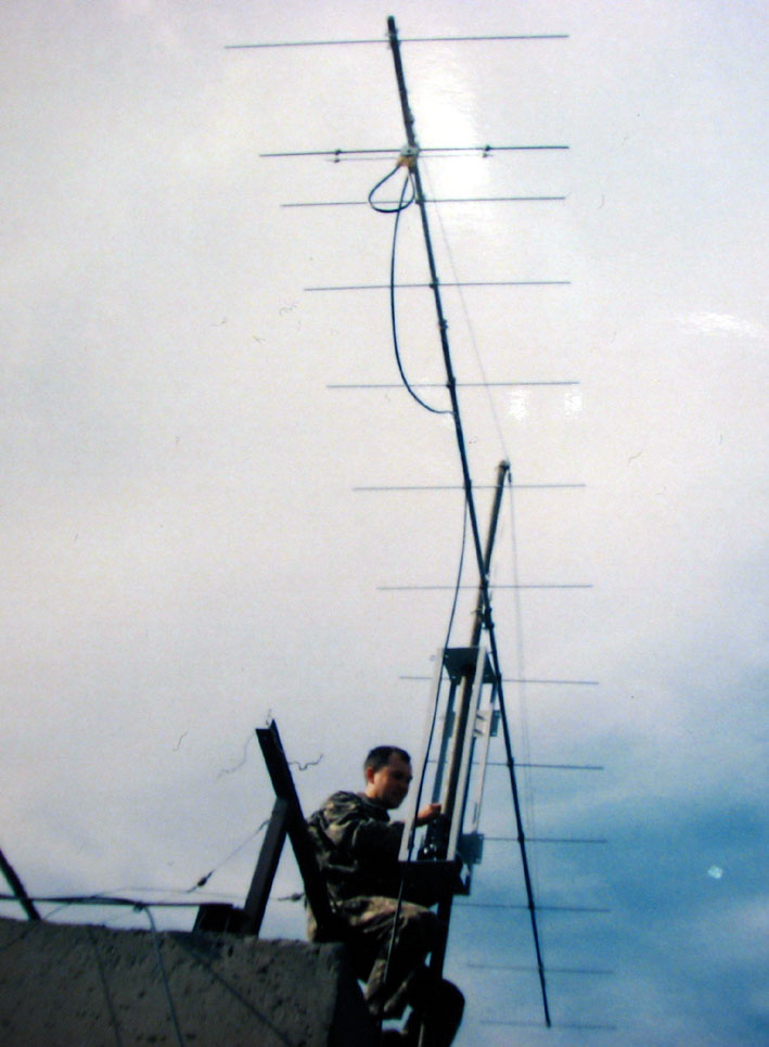

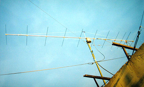

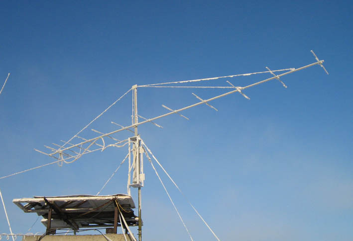

  I made my first antenna for 144 MHz in 2003 year - only 4 elements yagi , in also in 2003 year I made 11 el DL6WU (optimize by ex 4K6D - UA3WM)
My old 11el DL6WU

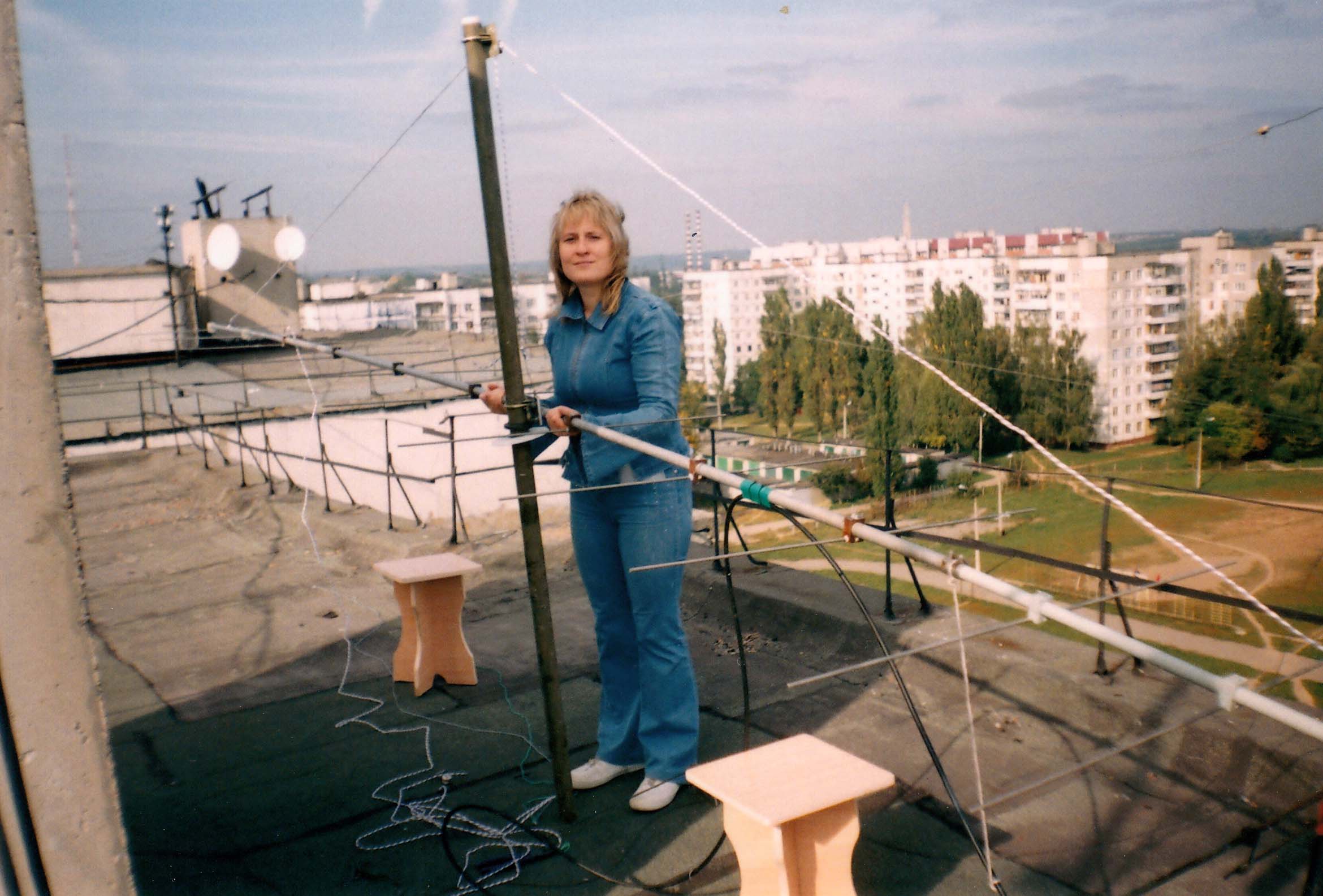

I added 2 elements and mounted new rotor G-800 in 2006 year
My XYL helped me set up new antenna

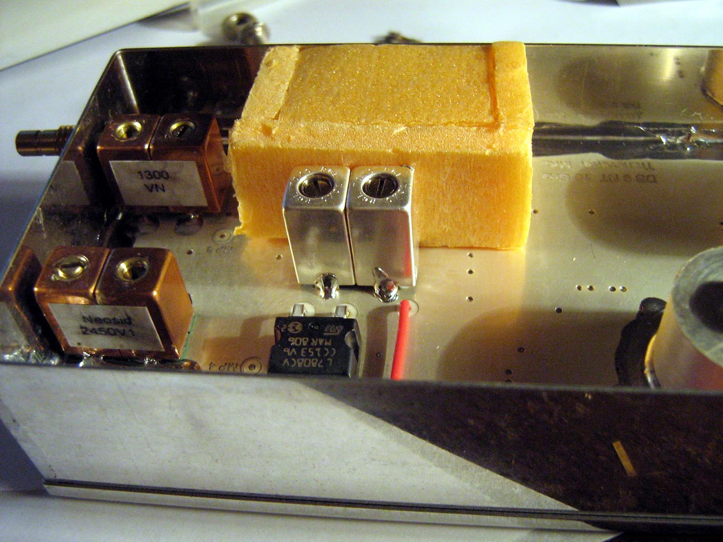

LNA :
____1) MGF1303B Nf < 0,5 db - See Photo LNA 3P325
____2) MGF1303B Cavity construction Nf < 0,3 db
ANT : 13 el DL6WU 3,5 WL

LNA : 1) ATF35143 Nf < 0,2 db
_____2) ATF35143 NF < 04 db - See Photo and New Photo:
144_432_1296 LNA * Step by step * inside LNA 1296 MHz

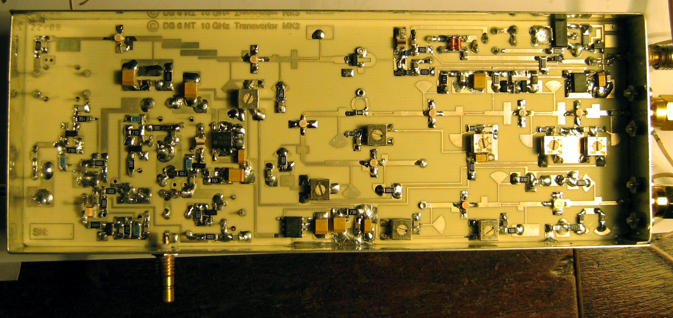

Home made XVTR-KIT 10G2 by DB6NT with some modification
IF freq 144 MHz , LO 10224 MHz
Home made PA for 10 GHz , power about 4 W
LNA : LNA from SAT converter , also home made MGF4919G

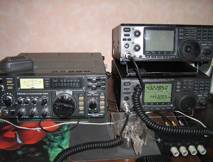

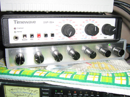

My equipment : Old Transceiver ICOM-745 and IC910H + DSP filter TimeWave DSP-59+

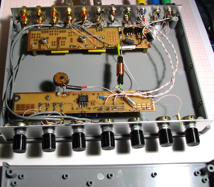

Two Channel Shack
Audio/PTT/Remoute Integrator
- Independent Two Audio Amplifier - K174UN31 (KA2209,TDA2822M)
- Splitter PTT for 3 independent line
- Isolation between two sound cards and 4 independent radios
- Filter for reduction pulse QRM and noise from supply line

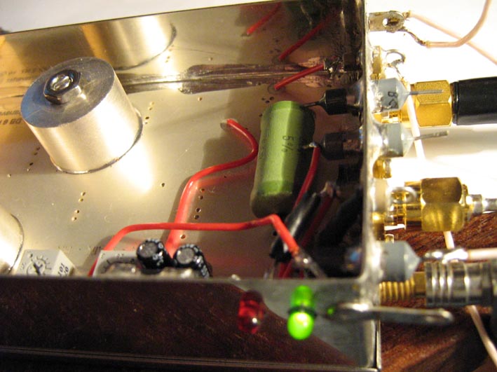

In 2008 year i assembled 10G2 transverter-KIT by DB6NT, for more info look here ...
Easy solder SMD and fast alignment :
