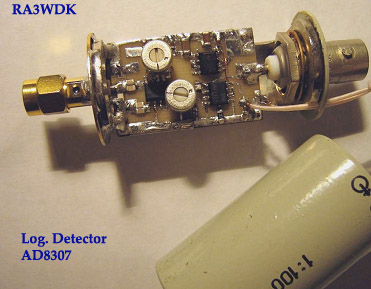

Meter for measurment Noise of Moon and Sun
Digital Noise Meter
Noise Meter uses Log.Detector AD8307 , ADC by MCU ATmega16, Precision voltage regulator LM4040A, thermometer DS18D20 in noise source
