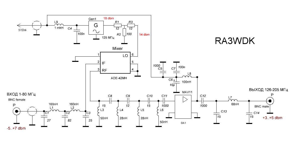

UpXVTR for NWT-7
I made and use UpXVTR for measure S21 and S11 120-210 MHz

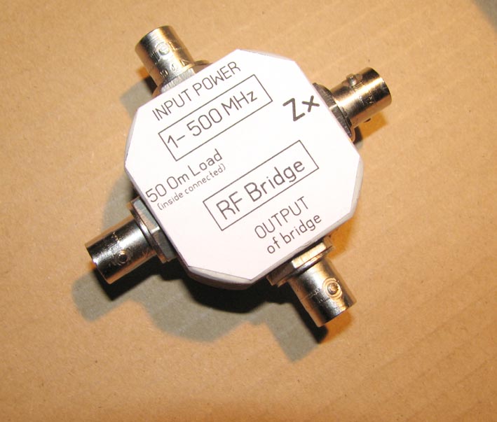

Bridge for measure SWR from 1 to 500 MHz

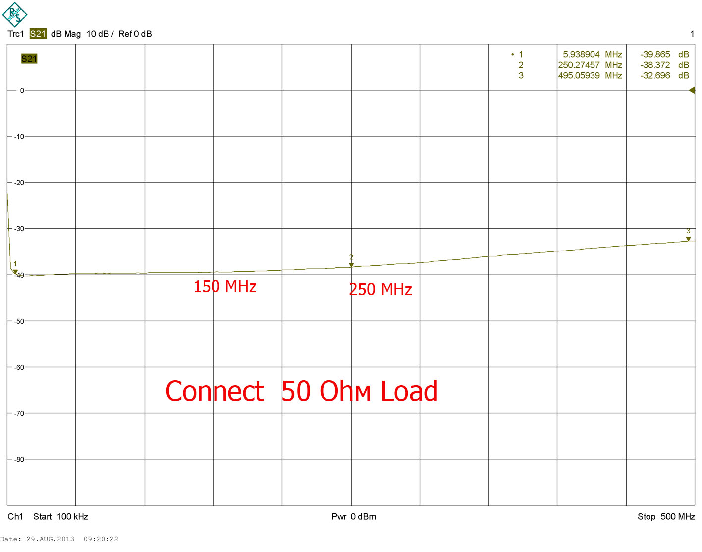

Measure Return Loss with connected 50 Ohm Load
