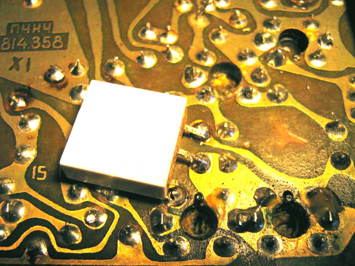

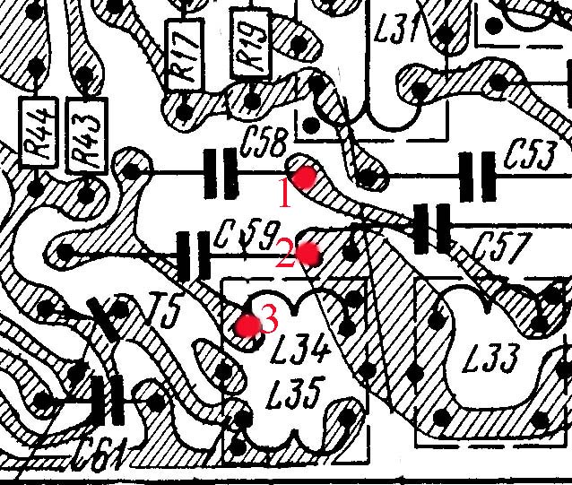

I have made also CW local oscillator (LO) in IF frequency 465 kHz. This LO mast be set near IF amplifier and receiver modification to enable them as CW/SSB-reception.
These are the VEF-202 IF filter modifications with ceramic filter 465 kHz.
The VEF-202 uses the simple LC filter 465 kHz with bandwitdh about 13-14 kHz and not good selectivity perfomance. You can install low cost ceramic IF Filter PF1P-õõ with bandwitdh 6-8 kHz. (also FP1P-õõ)
After you installed ceramic filter - you mast adjustment L32 L33 L34
and may be L36 for better bandwidth and min loss in passband !
