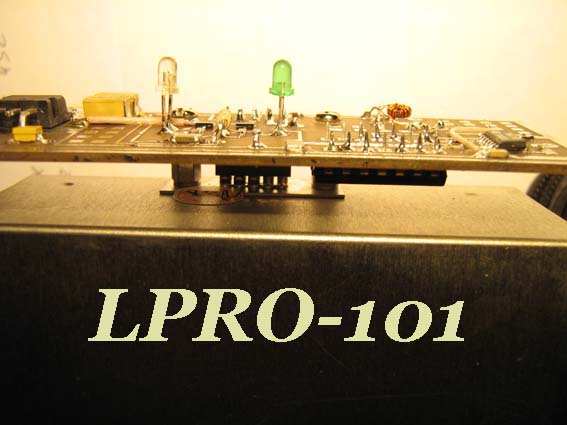

10 MHz Rubidium Frequency Reference EFRATOM LPRO-101
I use Frequency Reference for operating on the microwave bands 5,7 & 10 GHz with narrowband modes (CW)

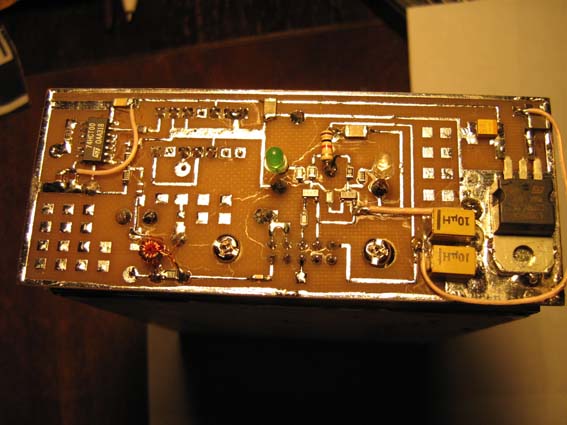

PCB Sprint Layout 5.0 file
I use small power beacon with TXCO 10 MHz for control my microwave system from precision frequency of EFRATOM LPRO-101.
Beacon make many spurious - and have good level 5760 and 10370 MHz for comparison and calibration my LO XVTR 6&3cm.

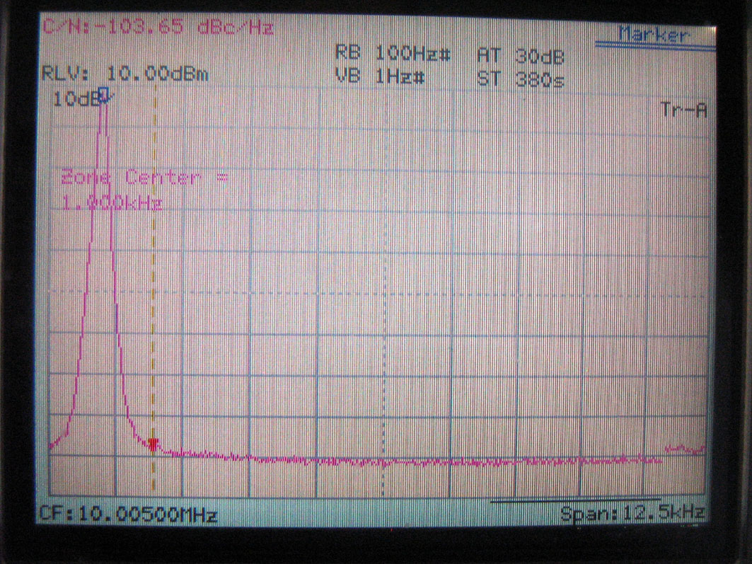

Spectrum measurements with R&S spectrum analyzer
Spectrum measurements with Anritsu spectrum analyzer, Fnoise better 100dbc/Hz.

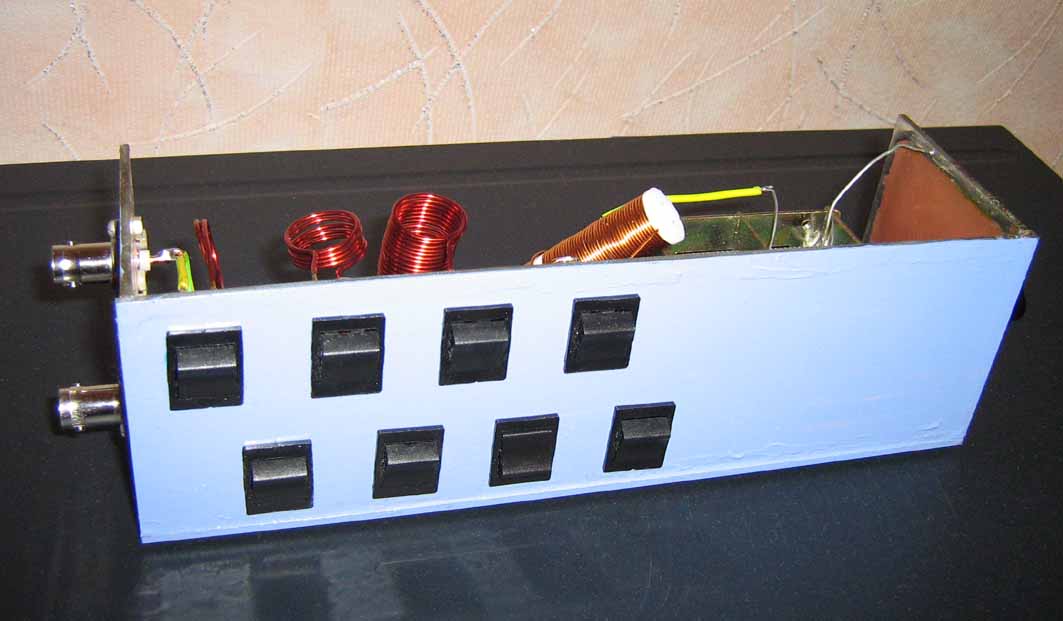

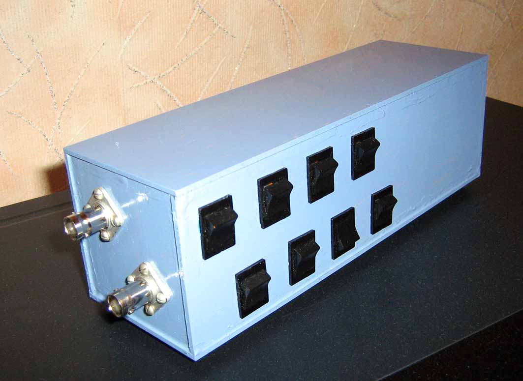

"Lazy" LC tuner 1,8 - 30 MHz

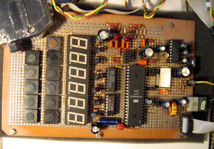

My evalution board for MSC-51
Homebrew evalution board :
CPU - AT89S8252
Available 2 Clock 24 MHz and quartz
ISP programming via LPT port
IRF port / Led port / 6x8 Segment port
IRQ port
RS232 port (max232)
Sound output , simple keyboard
