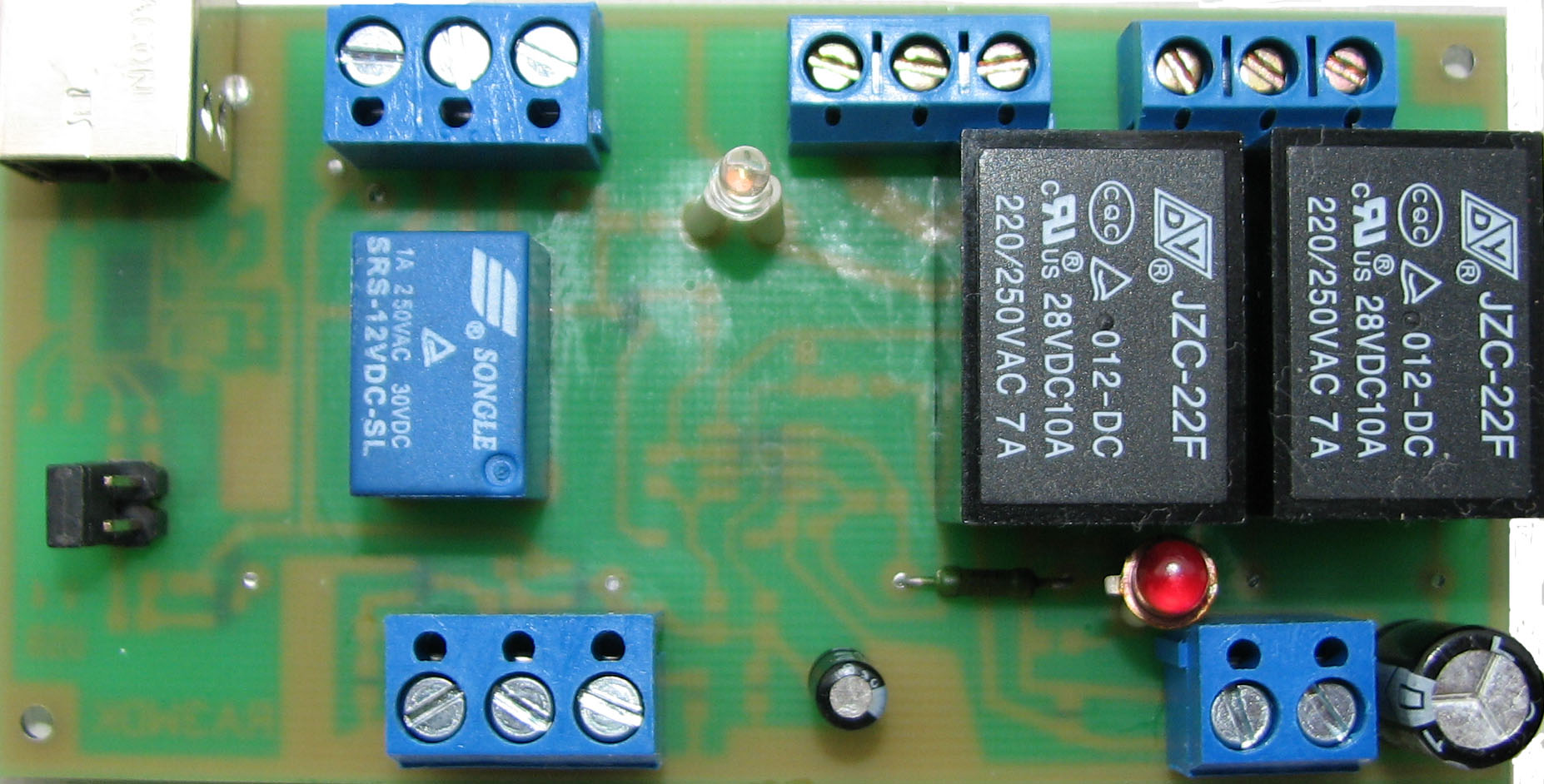

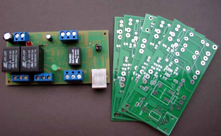

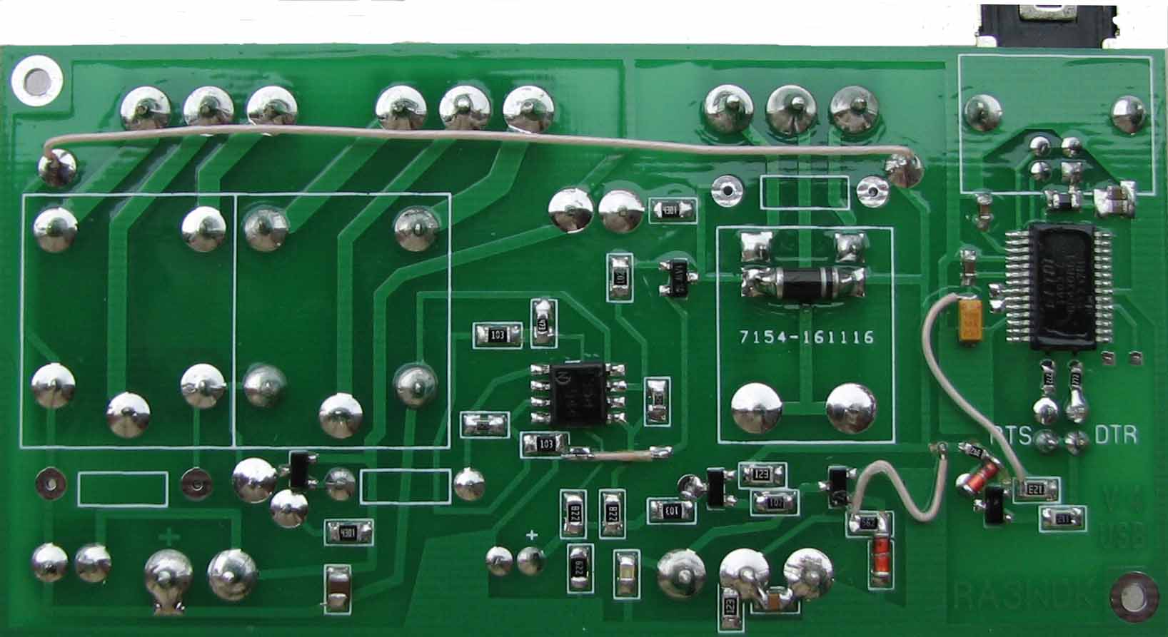

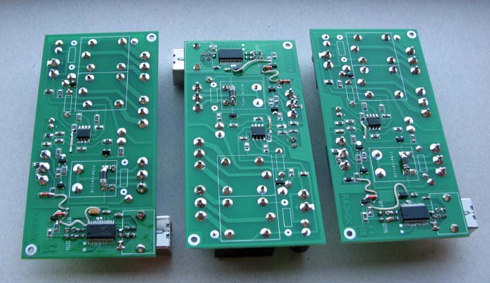

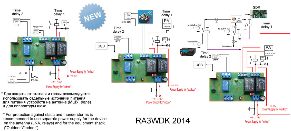

2 Time delay SEQUENCER
New version 5
New features, now with USB interface!
PCB file (Gerber format + CAM file)
Possible configurations

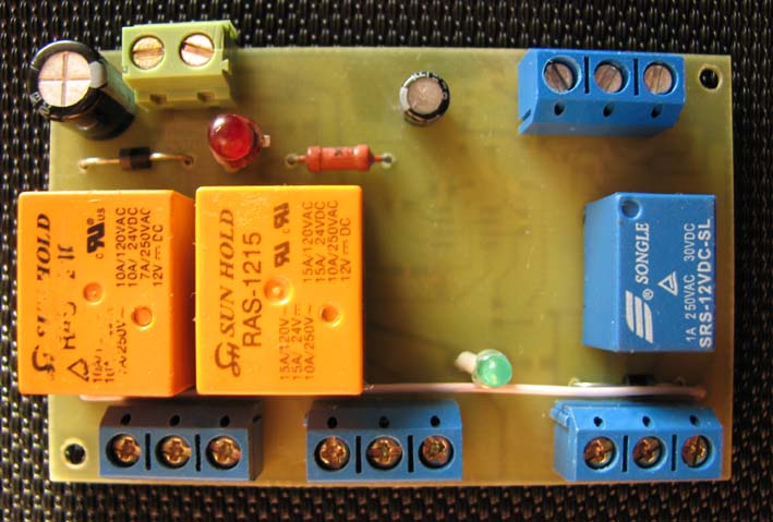

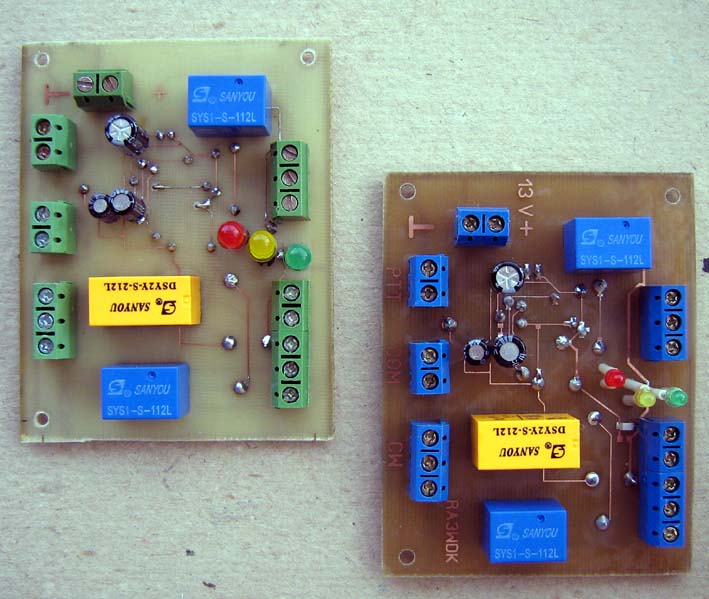

The old version of sequencer

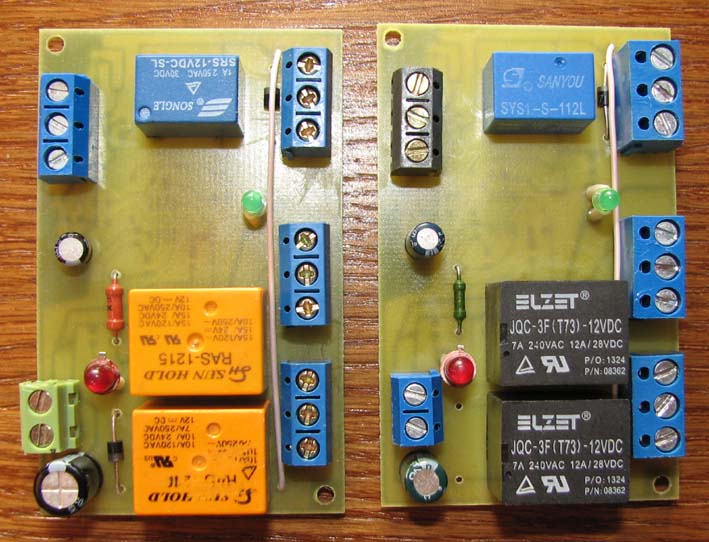

SEQUENCER with 3 levels of delay
This sequencer has not any MicroProcessors (MK or PIC) , uses simple 4 comparators (LM339xx).
This sequencer does not make QRM for RX. It has remoute from PTT and COM-port PC.
You can download circuit diagram (RUS lang.) , PCB (Sequencer.lay)
Connect sequencer for 3 Bands
for 3 band
for 3 band

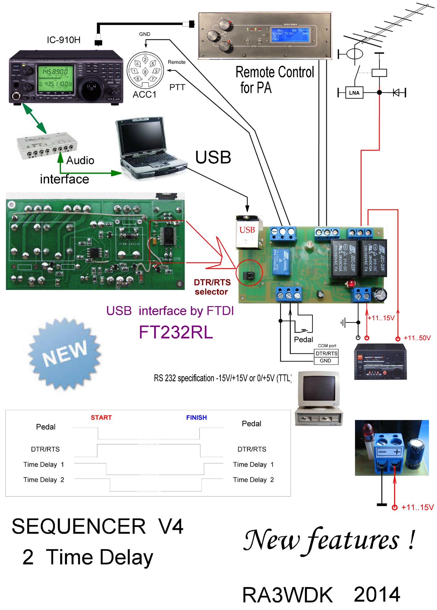

  USB to serial UART RS-232 + PTT from DTR/RTS
PCB file (Layout v6 format)
Sequencer for HF RIG
PTT
