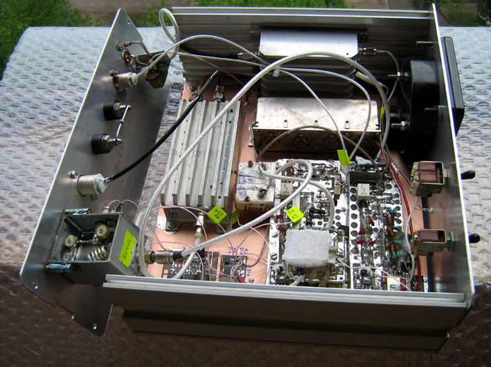

My transverter 144/28 with high dynamic range
I saw at 2004 years Javornic 144/14 design by S53WW and designed my XVTR.
Transverter with high THREE-SIGNAL DYNAMIC RANGE :
- Local oscillator (with temperature-compensated) 116 MHz. Phase noise LO is better -150 dBc/Hz at shift of 10 kHz and better -145 dBc/Hz at shift of 1 kHz !
LO for all my XVTR (144,432,1296,6cm and 3 cm) by UA3AOH !
- High IP3 Level frequency mixer SYM-18H (Mini-Circuits, LO +17dbm)
- High IP3 level in the receiver low noise stage with 2xBF981 and BFG591
High selectivity with 4-stage helical band pass filter (from FM-301 Hungary FM stations) - more 70 db rejections outband 144-146 MHz. Also final low pass filter rejection spurious and harmonic of more than 60 db (filter LPF also from FM-301 with modifications).

Different between PRO Version and Light Version - in "Pro" use second unit for only TX-stage : second filter , TX stage and second high level mixer. In "Light" single filter and mixer use for RX and TX.
The TX power of the transverter can be adjusted with the potentiometer on the front panel - adjusted high level balanced stage 2xBF961(981) .
PA: use RA13H1317M about output 20 W , Circuits level control : 2...20W
Precision generator 5 MHz , calibrator freq. 145500, 1 ppm stable in 4 years period
Filter - 4-stage helical band pass filte for TX and also filter for RX circuit
. Sequencer circuits with remote control coaxial relay.

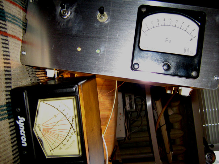

The output power, input IF power and SWR is indicated on a meter in front panel.

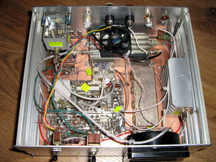

Modifications 2011 :
- new design TCXO for LO unit
You can see fabrication stages similar to mine XVTR for RA4SD
PA module RA13H1317M power out 30W
The sequencer is inside :
Delay of giving of power from IF 28 MHz
Delay of inclusion PTT for TRX and PA
Input and output of 144 MHz are separate !

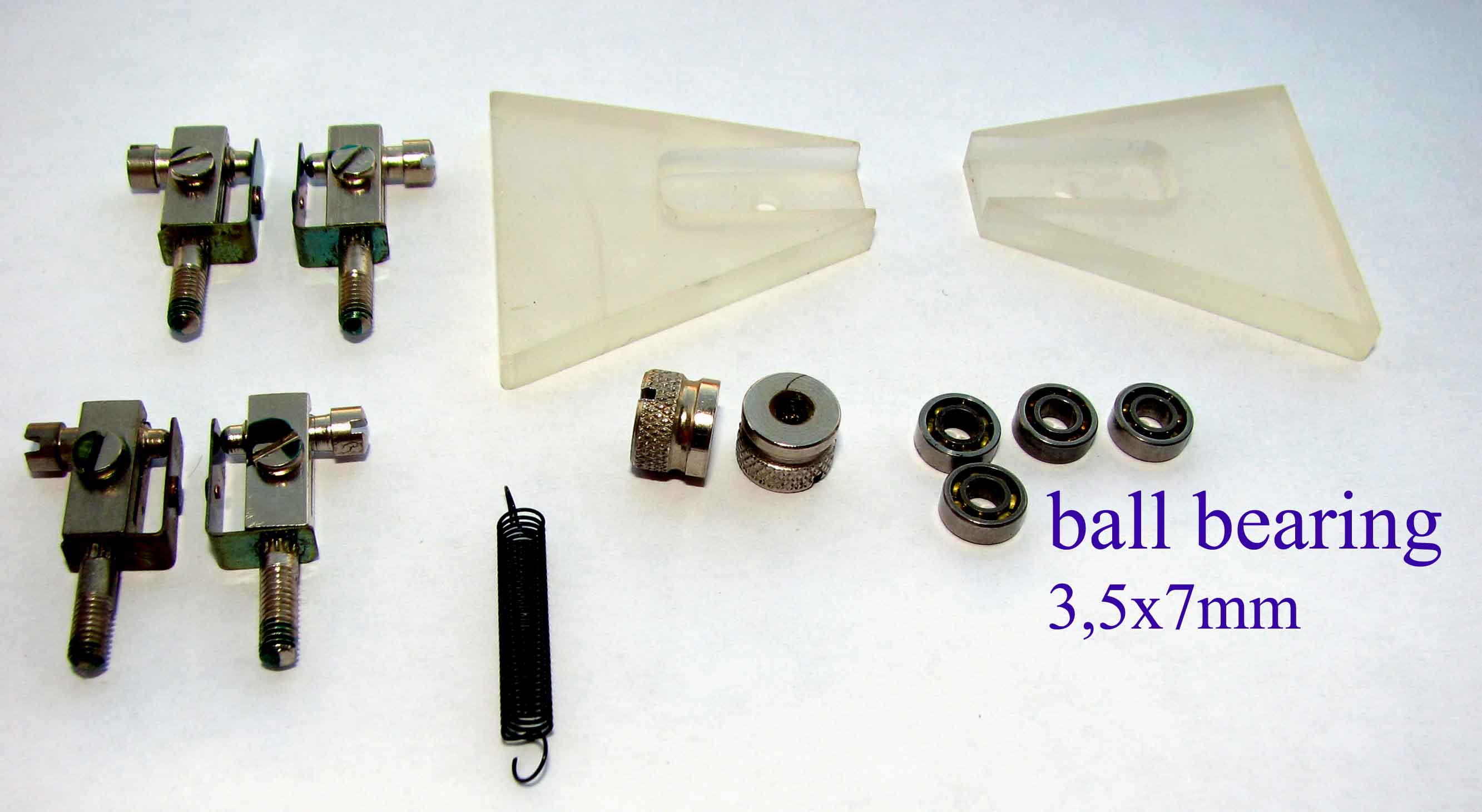

Home made Iambic paddle key (1999 year) , weight about 1,5kg , 4 ball bearings .
